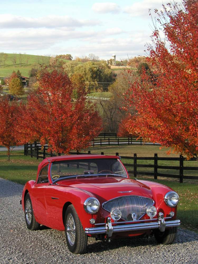

I too am a new member and also am in the process of restoring a 55 bn1. Do you have any pics of your 54 to post here or email me? I am considering painting mine in red.
Dennis
Hi Dennis,
Thanks. I'm a little new at this but I will try to attach a photo of the 54 Healey. We color matched a spot on the underside of the front shroud. What we came up with that matched the closest was 1988 Ford Bright Red. We used that on the chassis. I had someone else paint the body who used PPG paints and used a paint computer (spectrometer???) to match that color exactly. I've had many complements on the color.
Kurt
