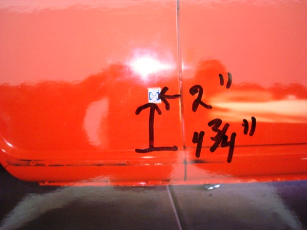

I don't know if all the cars were the same. I've seen them put all over the place. I was going to post a picture of a picture of my car before restoration with the original paint on the fender but my camera is dead right now. The picture shows the measurements as. 2" from the side edge of the fender, and 4 3/4" up from the bottom of the door edge line. If you need I can post a picture on Sat. I took this picture to show me exactly were it was placed. I then marked it with the measurements.

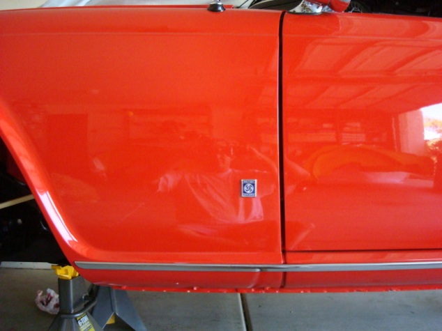

Here is a better picture than the previous one I posted.

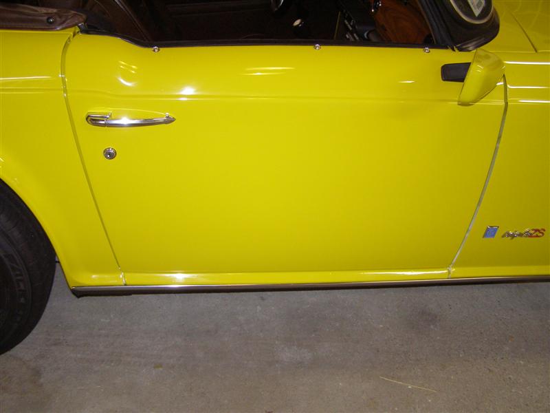

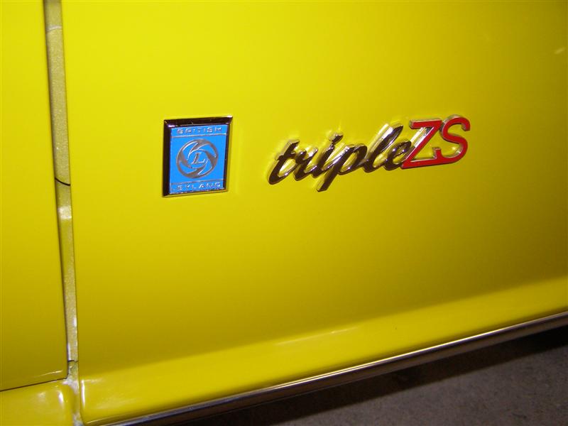

Mike this is a picture I took of the car as original before I started the restoration. The second is a new picture of the same location. As you can see from mine and Pauls car you just need to get it in the general area.

second picture

And when you do decide where you want them to go, use painters tape and a level to make sure that they line up horizontally and vertically. Mine may look like it's tilted, but it's an optical illusion from the angle that I took the picture from.
Due to another car in the garage, I could not take a straight on picture like Keith did.
