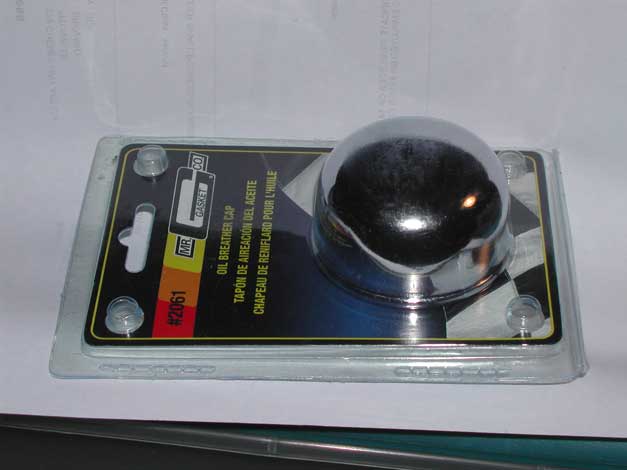

If the oil cap you have is similar to a radiator cap, it probably is not vented, like the TR4 cap. I would use a vented cap instead. The stock cap is vented, but won't fit the aftermarket valve covers. I would use a cap like the Mr. Gasket #2061 that Mark Macy sends with the Offenhauser cover. Or just go to your FLAPS and look for one that fits.
