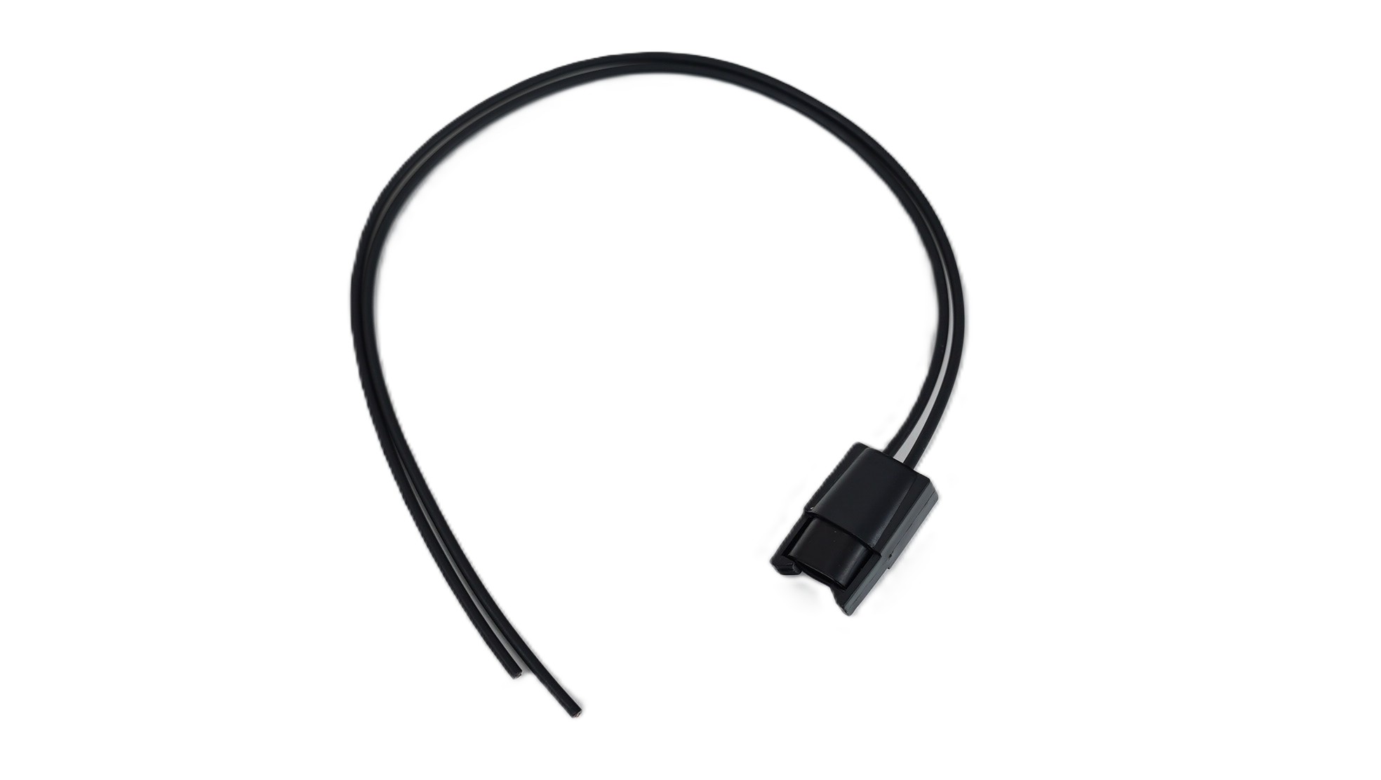

plugs, wires, dizzy cap/brass inners, red rotor, coil, electronic ign, timing check, fuel filter, carb soaked in soup/rebuilt, valves snugged, new silicone valve cover gasket addressed old issue the OEM brake light switch plug & how it connected to OEM & upgraded pwda often times would get loose from connection
TR6 owner on the net said he used > Brake Warning light switch plug / pigtail early ford bronco < ordered, spliced 2 wires into 1, firm connection & works on my '72
