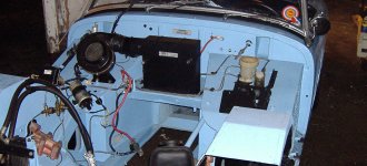

Trevor,
Please see the attached for how I ran mine. They caught up to the four splitter in its original MKIII location. I hope this helps.

I run a dual master set up in my Bugeye but not the tandem master.
I use the 67 Sprite brake master and a seperate clutch master. I PM a seperate message with a picture of the 69 Rally car. I can't figure out how to do attachements on this forum.
No funky 6 way valve/switch, just the 4 way spliter. Also it uses the later pedal box.

Thanks for all the suggestions. Pat, did you consider moving the junctions to the driver's side? Since my datsun slave cylinder is on the drivers side, I wouldn't need to run any lines around the firewall or heater box.
Trevor:
I adapted a MKIII plumbing design and tried to make it cleaner (off the firewall). Honestly, now that the engine is installed with a oil can/breather mounted, there will not be as much room on the drivers after I mount the K&N's. It probably can be done if laid out properly, I went with the tried and true method.
