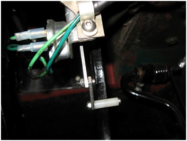

Later BJ8s (he says he has a '67, but the "year" of a Healey is mostly meaningless) do not have that relay on the inner fender. The failure to come on when the brake pedal is pressed could be due to the bulbs, the light sockets (corrosion), the wiring (loose connections), but is most likely the brake pressure switch on the right inner fender. I got tired of replacing this switch, only to have the replacements fail in a short time. I replaced the pressure switch with a mechanical (adjustable) switch that operates off the brake pedal. It has the arm and roller described by mgtf328. That switch has operated just fine now since 2006.

Watsons StreetWorks, where my mechanical switch came from, says that pressure switches fail because they don't "wipe" the contacts and over time they carbon up. The mechanical switches do wipe the contacts, and therefore last longer. That's what they say. I only know that my stock pressure switches did fail too soon after installation, but the mechanical switch is still doing its thing 13 years later. Looks like the current version is $4 less than I paid in 2006.
I installed a mechanical switch several years ago and it has worked flawlessly. A mechanical switch will activate the brakes lights with light pressure compared to the original switch. This alerts people behind you much faster that you are braking.
Your setup looks a lot more professional than Roger's TBH. He used a microswitch with a long(ish) lever that just laid across the pedal shaft. I'm gonna try the 'extra sensitive' hydraulic switch then do a mechanical if that doesn't work. I think I've only had one failure of the hydraulic switch in 35 years/150K miles.
