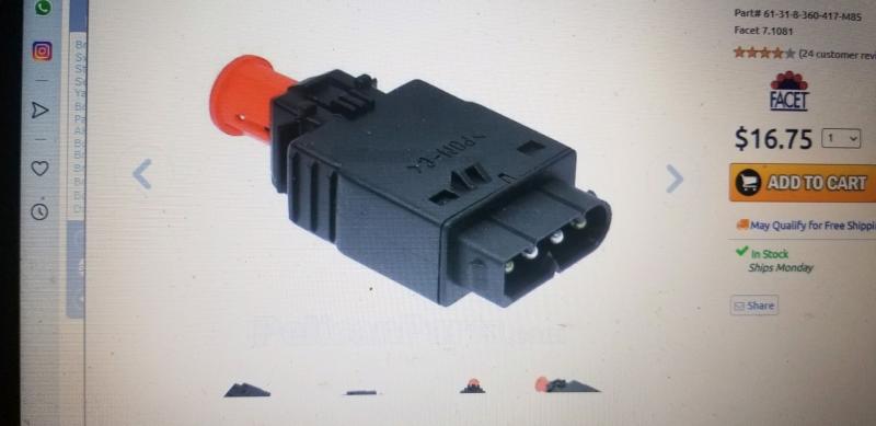

Here is a photo of the connector on the switch I am trying to use.
May have to go to a junk yard to get the pigtail.
David

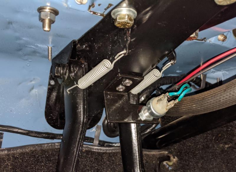

Hi Dick
Switch I used closes as the pedal is moved away from the switch. Here is a picture I just took of my set up showing my homemade bracket and the switch. Has worked very well for a few years.
Cheers, Mike
