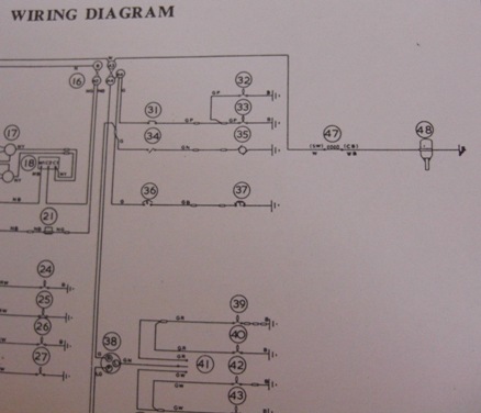

Here is a part of the BE wiring diagram.
A3 supplies 12V from the switched side of the ignition switch (white).
The fuse is between A3 and A4 and is jumpered internally at the fuse box over to the second A4 terminal (let's call that A4(2)).
If the car is wired per the schematic (how do we know?), A4(2) which is green supplies the switched 12V to the brake switch (#31)(about 12" away).
The second A4(2) (green) wire travels into the dash area and supplies the Heater switch (#34) and fuel gauge (#36)and the windshield wipers (#46 off the page).
A4 is a single green wire and it supplies switched 12V to the flasher unit for the blinkers (#38).
Kevin has said that he checked all the wires at the fuse box.
If I was to bring out my big crystal ball and hazard a guess what is wrong, I would say that only the brake switch wire is connected to A4(2) and the other two green wires are connected to A4, AND the problem is that the internal connection in the fuse box from A4 to A4(2) is suspect!
With the right understanding of electricity and the wiring diagram, and a VOLTMETER Kevin, this is as easy as it gets to troubleshoot. You don't even have to go under the dash on this one! If this is too technical, excuse me as I R A engineer.

I bought two bulbs for my continuity tester on the way home, but the kids wore me out at work today. I crashed as soon as I got home. Scott, can I translate what you said for me? Aren't you still saying to check the continuity of the green wire for the brake lights by hooking up my tester to the green wire only at the fuse box and the green wire at the brake switch? By the way, I have the heater wire and brake light wire hooked into the same post on the fuse box as this looks like what I am supposed to do if I am reading the wiring diagram correctly.
Kevin
Problem solved! As TOC and JP speculated, it was the fuse box. Specifically it was the connection between the two A4 terminals. The A4 terminal to the outside does not work. The way I found out is I connected each of the three green wires to the first A4 terminal one at a time, labeled each, and all worked. I then connected each to the second A4 terminal and none worked. I don't know how the fuse box could work and then all of a sudden not work, but luckily I have a spare fuse box somewhere I will put in if I can't figure out what is wrong with mine. In the mean time, I have all three green wires into the first A4 terminal and everything works. Not happy about all the time I spent, but on the other hand I learned a little more along the way. Thanks again everyone.
