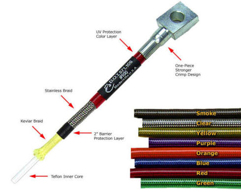

olphartz provides a photo that show how their stainless are made. Maybe helpful in comparing with other brands.
https://www.olphartz.com/stainless-brakelines.html
