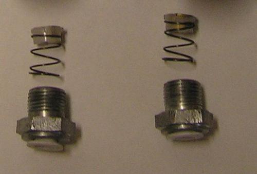

The valve should be on all US spec dual master cylinders. Here's a poor pic that I found.

They are sometimes called trap valves, sometimes check valves. If you look on the Moss brake parts picture they are items 21 & 22.
The check valve is the little thing with the spring. It's inside the master cylinder. That larger metal piece is what screws into the master cylinder and you screw the hydraulic line into it. I'm sure that's not missing, or you wouldn't be able to attach the brake line, but the inside piece could still be defective or installed wrong.
