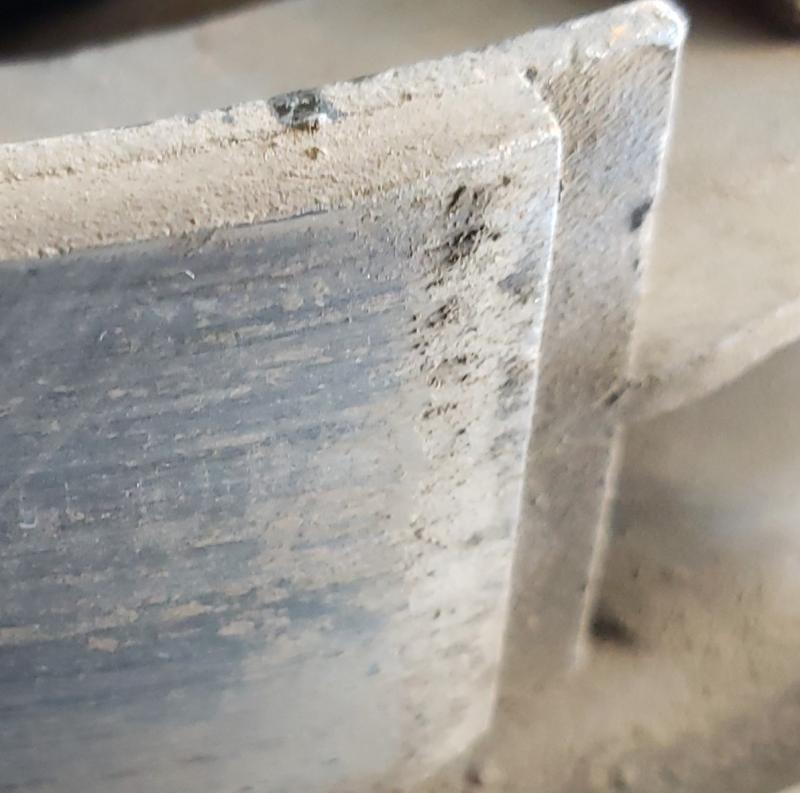

Bob here is my brake shoe. Still having problem so wonder if this rough area on toe or is it heel of brake pad could be causing shoe not to release until I turn hub a couple of turns. Thanks Marty
Looks to me like the shoe lining is just a little oversized (this is what brake shoe 'arcing' is supposed to prevent). My feeling, since finding someone who can arc shoes is almost impossible, is just install and let them be 'arced' by the drums. I have no idea if this is a good idea or not, but it's never caused me any problems that I know of. The alternative is to grind or sand--beware the dust--the edges.
