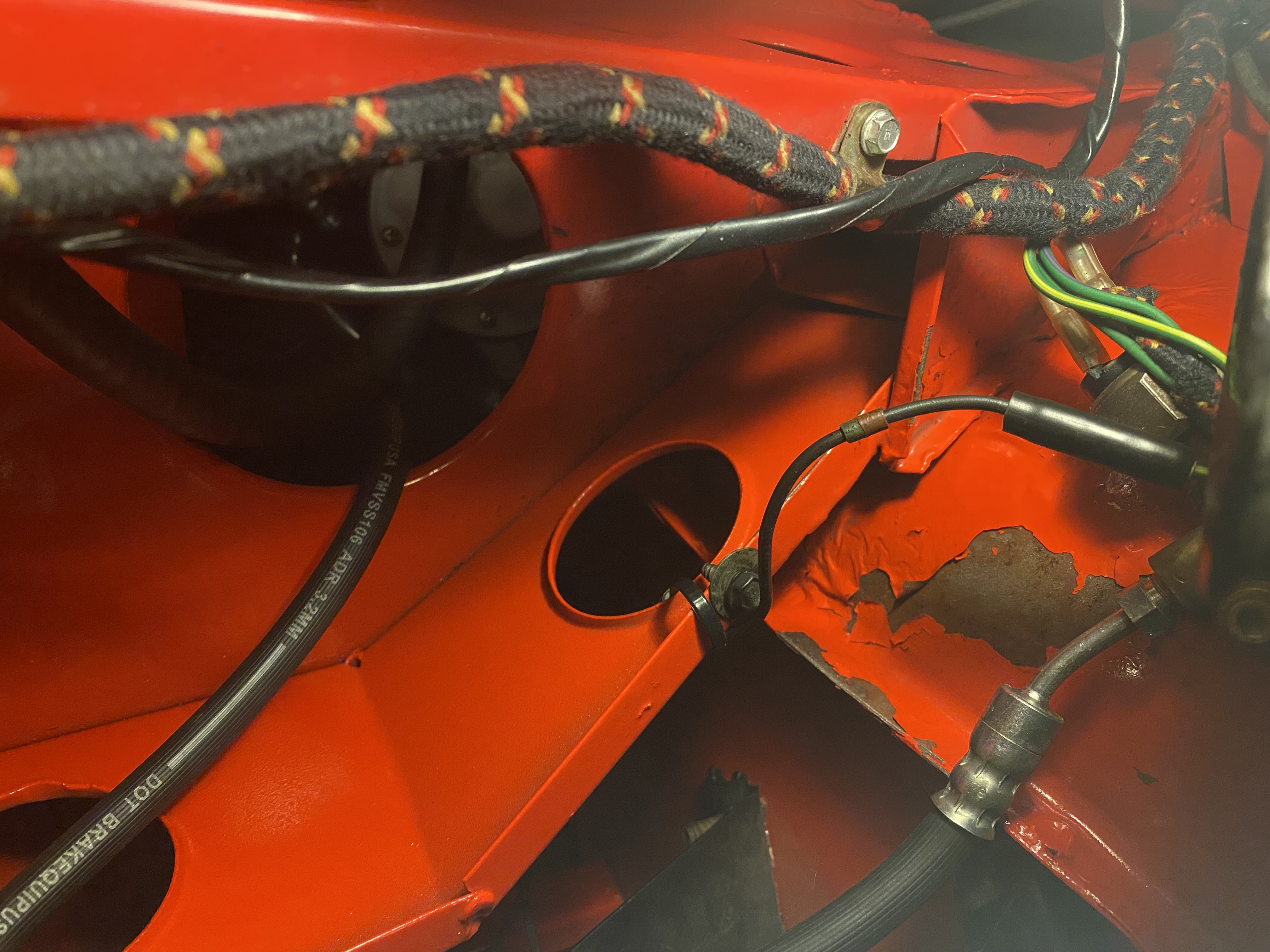

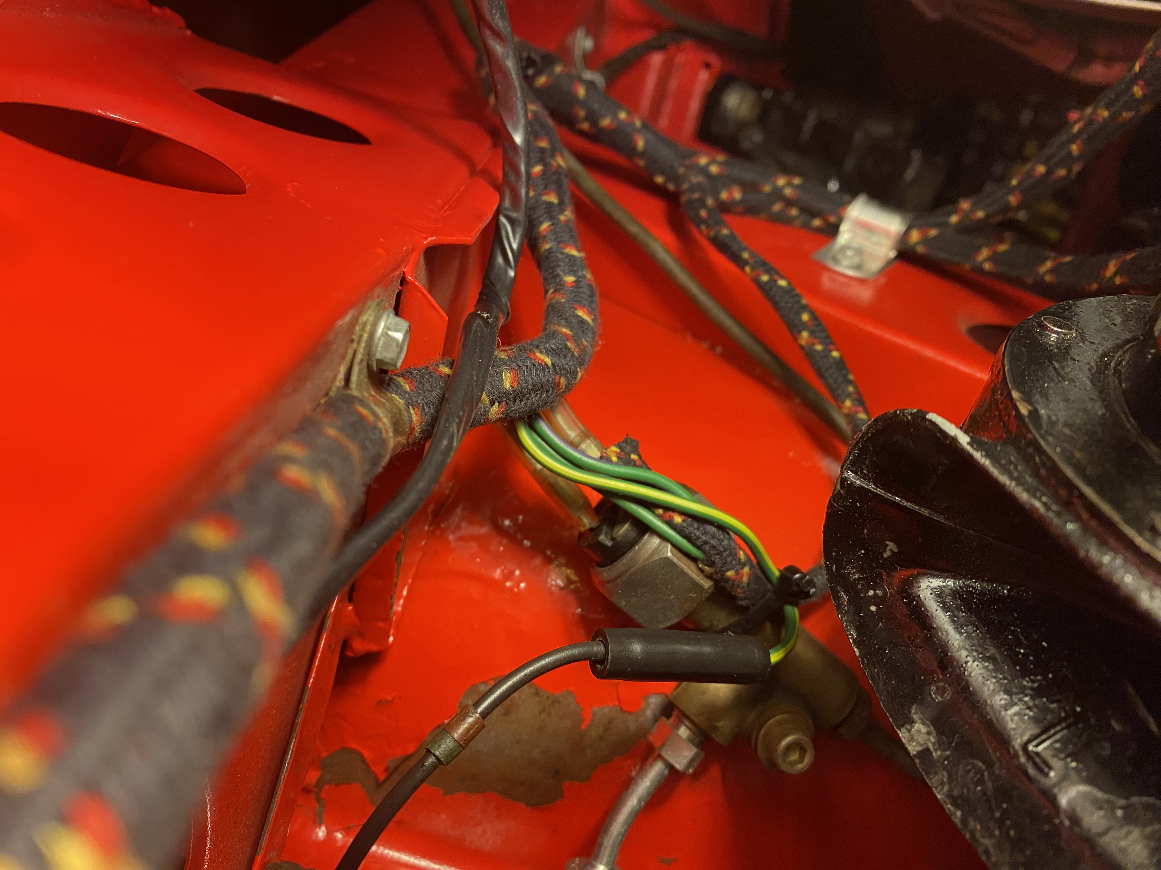

Bought the car in October and hadn’t noticed this area inside by brake line. Does this look fairly recent or could this have been done when a line was replaced. Nothing damp, but metal starting to rust. Reservoir appears to be holding fluid.

If it was recent, I'd think that you'd see fluid, bubbling paint.
Not an original brake line. The only rubber lines are from the front shock towers to the front brakes and to the rear axle.
To me that looks like simple poor paint preparation in that area. Is there any sign of primer paint? Perhaps they got tired of etching and cleaning and just shot some top coat. Usually when brake fluid or some other chemical dissolves a paint layer there are some crinkly edges where chemical action is still going on. That looks like it just flaked off in that area. Keep an eye out, there may be more to come. Not the worst thing you could find. Just clean, etch and repaint if you like.

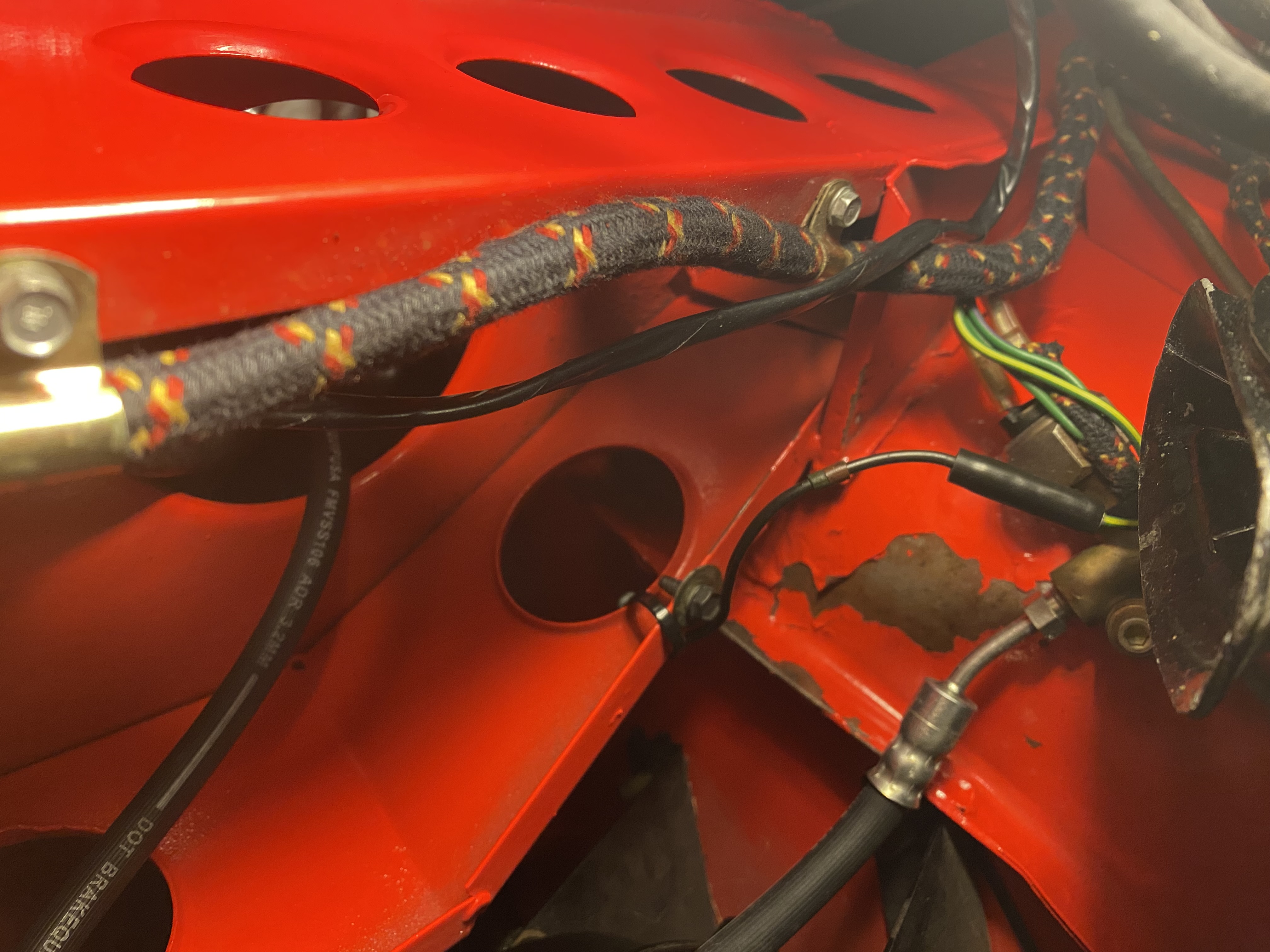

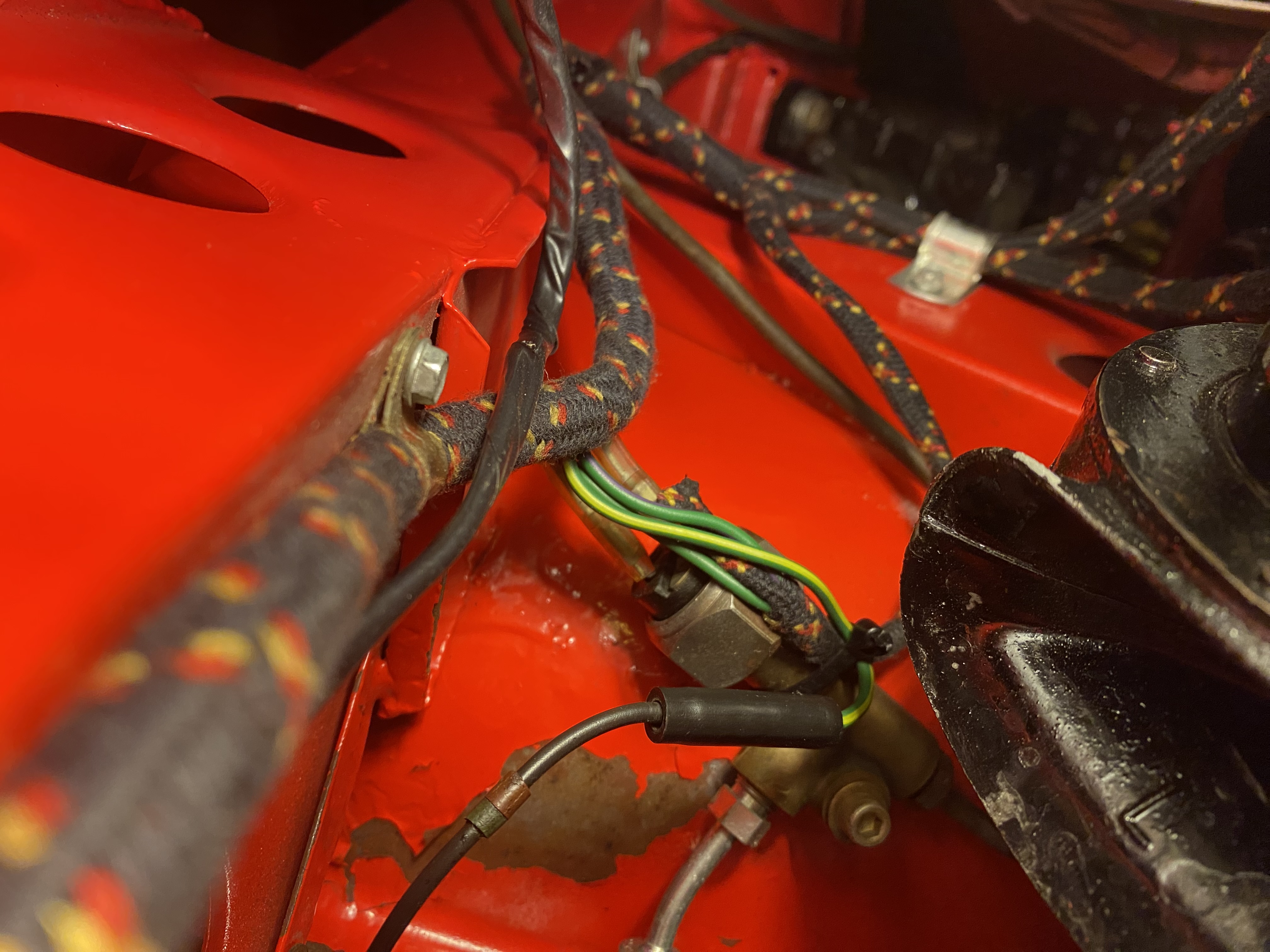

Another shot shows some crinkling further down, but I agree with your thoughts. No sign of primer. Car was stored in a heated garage for many years and now it’s not. Glad it doesn’t appear to be fluid damage. Appreciate your help. Ed
