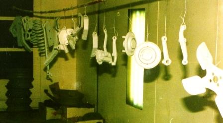

It was 22 years ago that I had my rear drums for my 1958 TR3A sandblasted and painted the n same as the frame etc. with Dupont IMRON black glossy paint. Now - 105,000 miles later they sill look the same as they did 22 years ago.
