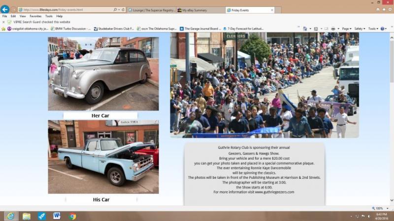

Here in Guthrie, OK we celebrate 89er day (actually 4 days) each year. Friday nite is the "Gezzers, Gassers & Hawgs" show. Last year, on the spur of the moment we put our Vanden Plas Princess (old British limo built on an Austin truck chassis) in the show. Thee are no die stamped panels. All hand made. It is mostly alloy body. Front fenders are steel. All else is allow. We have a lot of fun with it. When friends come over, we like to chauffer them to dinner.
Guessed someone liked it. It is one of two cover cars for this years ad.
