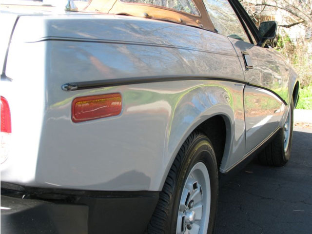

Does anyone know if the pin stripes are factory? I'm thinking not, but I've seen quite a few with similar stripes. They appear to be tape, not painted.
The thick trim strip turns out to be riveted on :frown:
I was hoping for an easy removal. I still might take it off, and fill the holes with plugs, especially if I can find some gray ones. Or maybe I can find some silver/gray trim that isn't so big.

justin_mercier said:
Those are factory, they were an option. My 1977 wedge has them as well.
Really? Are yours black or body color?

As far as I know that trim was not a factory item. I do not recall seeing any sales lit or anything that had them installed.
It could have been a dealer option....but most likely a PO installation.
Rivets? Really? yikes.... The ones I have seen were just double sided tape.
Mine are riveted on as well. According to the original owner of my car it came off the truck with them, not a local dealer installed item. Likely not a factory installed option while the cars were in England either, which would leave a strong possibility that they could have been installed in Leonia, New Jersey. Supposedly mine came off the trailer with the bump strips, luggage rack and sliding glass sunroof, all installed in New Jersey. To some, that equals factory installed.
