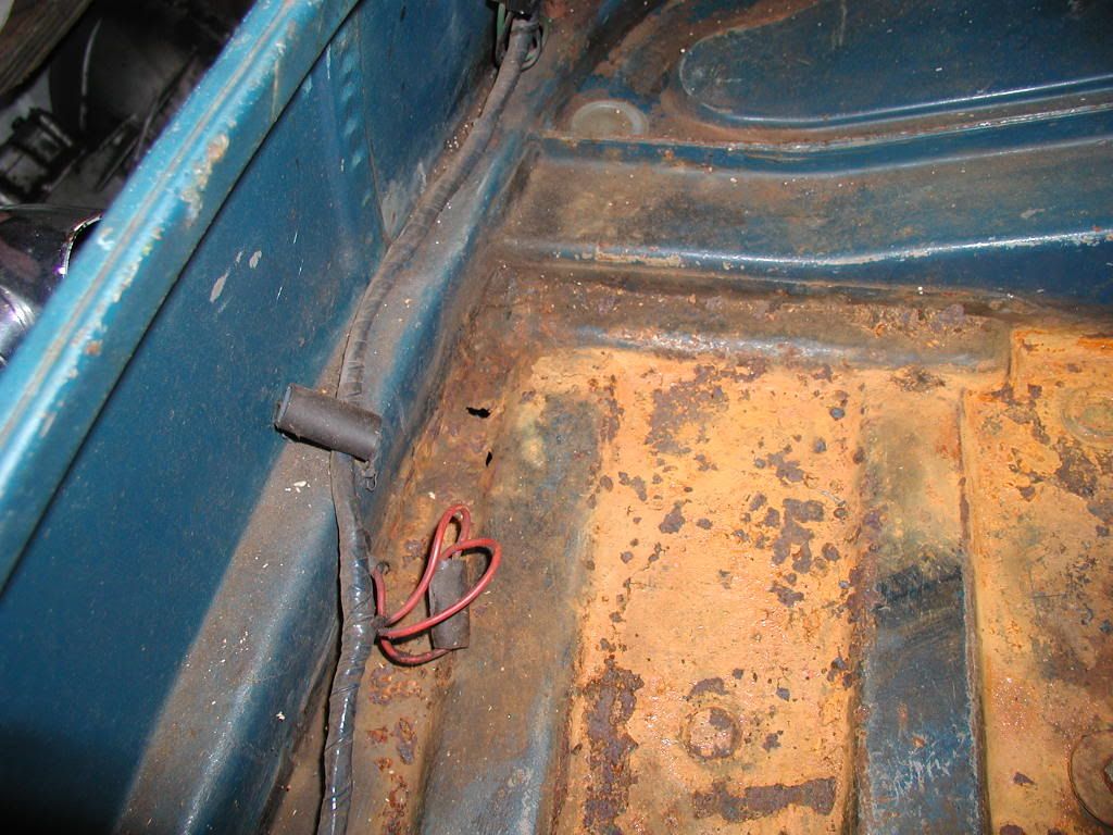

Well I bought the 1972 Blue MGB. The doors do have a gap about 1/16" at the very top and it opens up to about an 1/8" gap when jacked.
I opened up the rust and it seems very localized. The rear wing skin and the outer sill but only in that area. The inner has a waxy film on it and no rust. I took out the interior panel and looked down that hole an it looks clean.
The trunk has surface rust and a couple small holes. The drivers floor pan has 2 small holes in it, the right has only surface rust.
The right dogleg may have some of the same disease as the left but not as advanced. I just can't find any other rust through areas. I looked at a 1971 the other night and it was rusty so I kind got it figured out where to look.

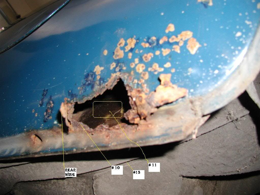

1st diagram shows outer panels: The dogleg is #35 in the diagram below; the rocker is #26...those are the panels that have the holes in them & will need replacing...the rocker rests right against the dogleg & the rust formed between them:
2nd diagram shows inner panels: #10, #11, #12, #13 in this diagram together form the 'frame' part of the unibody & are where all the car's strength is. Your rocker that has the hole in it is #10; I'm gonna bet that #11, the inner panel is also gone...your #12 bottom member (some folks call it the 'castle rail') looks good in the photo...look inside the car up where the sill meets the firewall to see if there's any rust in that sill (#13):

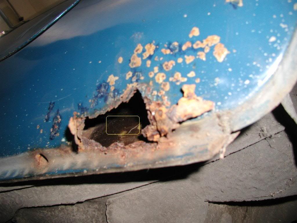

I edited this photo
by adding a yellow rectangle to show what I believe to be the inner sill id #11 on the IPB.
My examination of this area through this hole does not show any rust on part #11 that is visible , but that the surface of #11 is coated with a brown waxy coating. At the bottom of course where the multiple layers are on top of one another I cannot tell the condition. Looking down the sill forward looks very clean. I removed the interior panel on this side and looked in those holes and it again looks rust free, but again you can't see all the way to the bottom.

Hate to be the one to say it...you may be able to section the outer rocker...but #11, the inner, is completely gone! The only way to replace it is to redo the entire rocker...but, you're correct - looks like the inner & bottom pieces are good....one way to find out is to cut the dogleg away - after you have a new one to use as a patern....then you can get a good look inside.

You state that the inner is completely gone. Question, is the yellow rectangle located on the inner sill panel #11?
Then you state that I am correct looks like the inner and bottom pieces are good.
Do you mean, that if the inner is rusted or gone that the entire outer has to come off to be able to repair the inner #11?
Looking at the car and the IBP, the part #13 is the inboard most part of the sill/rocker, it is joined by #12 the castle panel to #11, which has #10 the outer rocker covering it. The rear fender dog leg covers the rear end of #10. The hole in the photo is rusted through the fender and #10, then next piece of metal going towards the center of the car would be #11. That is what I have the yellow rectangle on. If that is correct the inner is intact and the #13 is further in towards center and can't be seen due to the inner #11.
I don't want to antagonize, but I can't get to the car and want to understand what you are explaining. I also edited another photo
to try and clarify.
