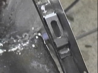

The boot prop rod on on my TR3 doesn't have a fixed place to rest as I prop open the boot. And I don't want to scratch the lovely paint job.
Can someone email me a few close-up photos and dimensions for the metal work that would hold the rod on the boot gutter?

Here's a start
Another TR, another view...
There was so much rust on this late TR3A that I had to fabricate new troughs all around the trunk lid and a new support like the one you need.
