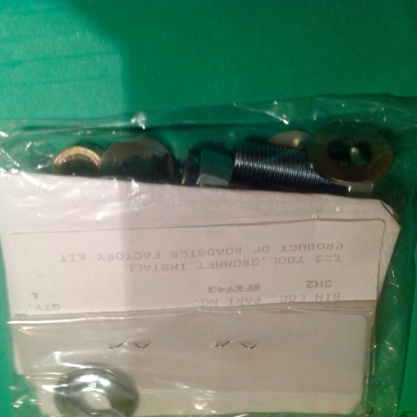

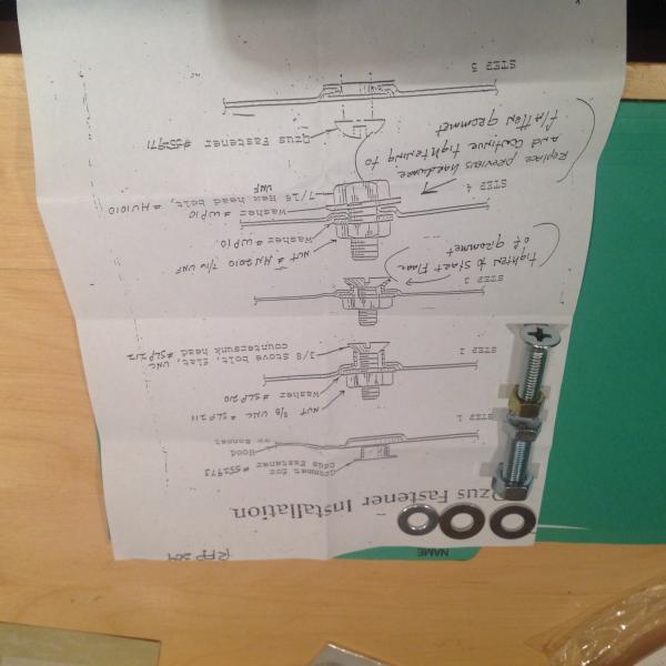

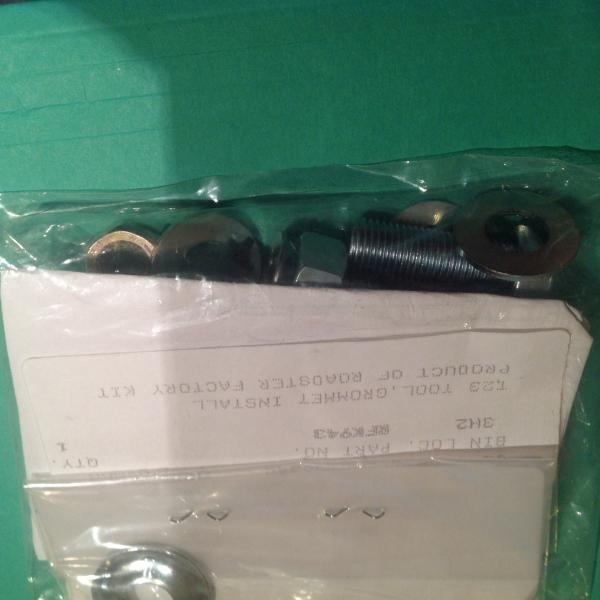

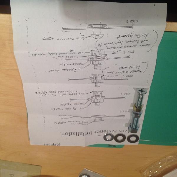

Hope this helps guys.
No idea why the pics are uploading upside down.
The kit number is RFK943
Cheers
Tush
Try this again
Well, even if I invert them, save them and upload them, they still post upside down...
Sorry
Cheers
Tush
