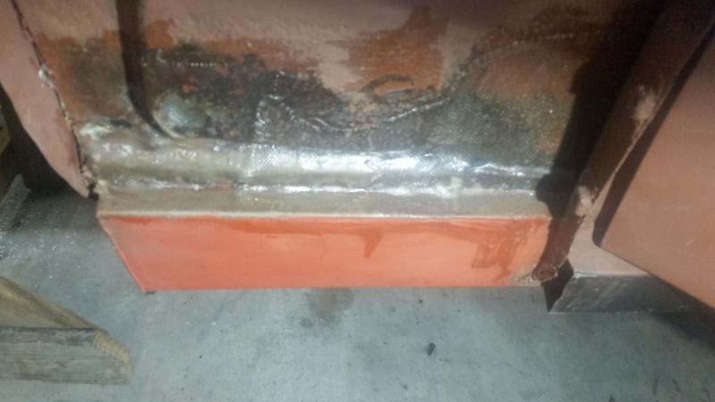

This is a sample of the PO Fiberglass work. Thought it could do structural repairs.

That work went right across the drivers side firewall and most of the passengers side as well.
