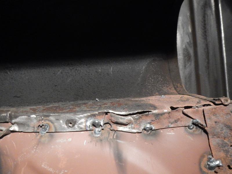

Trying to get everything on the tub to fit so I can align and weld the outer sill on the drivers side. Then I need to get the tub off the frame to get to the floor pan to tunnel seam the PO made a botched up job of it. I could not get to it with it on the frame so I decided to do that last before blasting and painting the tub. May be cooler and dryer by then.
This is his work.
David
That is the good area of the seam!!
If I knew then what I knew now I may well have cut the floors out and started over . May have saved me some time and trouble.

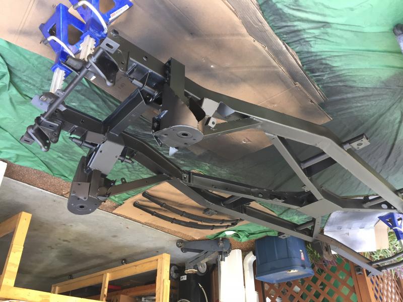

Not ready for the tub yet, but when picking up epoxy primer for my chassis my supplier also said epoxy prime first, then filler and then epoxy prime. Sort of a sandwich approach. Make sense? Chassis looks nice in PPG epoxy primer.
Nice chassis! I am sure the idea is that filler is actually very porous, so if the finish is chipped down to the filler it could wick water in to the steel, causing rust. Again, I know the correct way, but just haven't brought myshelf to try it.

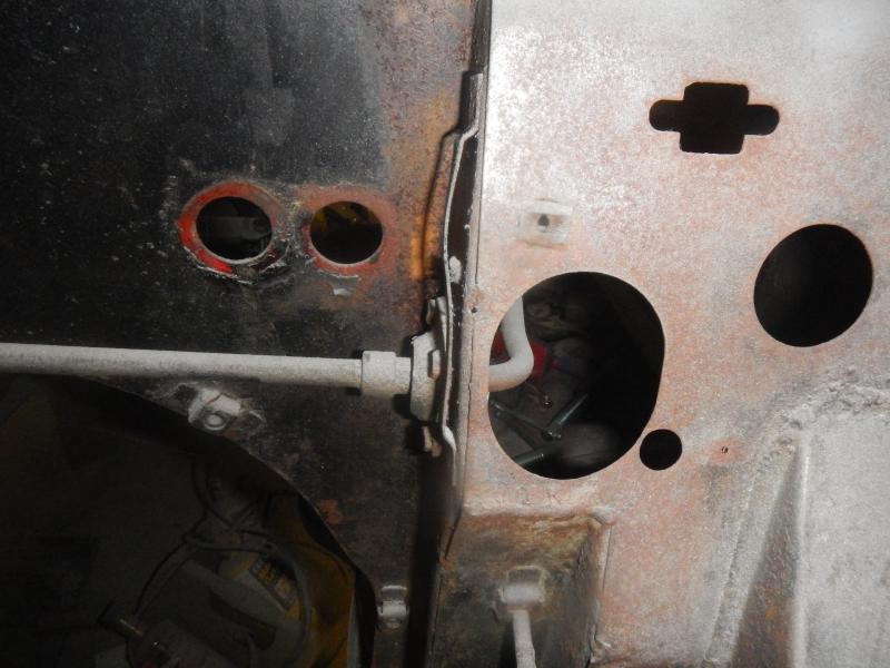

Any idea what the small straight clip is for? It goes vertically on both sides just in front of the throttle shaft.
David
The steering column seal folds over the corner and tucks into that tab. I'll see if I have a decent pic...
Nope, it's kinda hidden once everything is together. This pic should give you the idea:
I have not tucked the seal in in this pic, but it shows how the column seal is large enough to wrap around the corner of the firewall and then tuck into the slot.

Knew it had to be for something. Set up for RH or LH drive.
