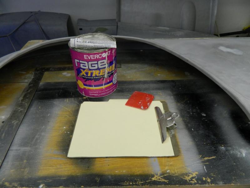

Had the aluminum one from HF got tired of wasting time and lacquer thinner cleaning it up. Eastwood and other have them with tear off paper for $15.00 to $20.00 for a 100 to 150 sheet tablet. I went this route:
File folders are about $15.00 for 150 ct. cut them in half. They work fine and soak up almost no surfacing material, they are rigid enough not to wrinkle while mixing.
