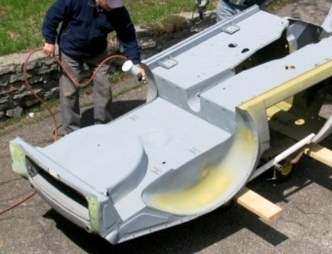

The other thing is that I picked some dolly wheels rated at 330lbs per wheel. I need to put together a jig to set the body on so I can roll it around for the transport. Anybody have pictures of how they created a jig?
Here's how we did one. Rolled it out to work on it and back in for the night.

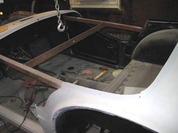

Here's a pic of how I braced the body, and if you notice, there is a hole in the cross brace that I used to lift the body (sans exterior panels) with an engine hoist. I guessed right, as the cross brace location perfectly balanced the tub. Since the engine hoist has wheels on it, I could move the body in and out of the garage at will. My garage will fit only one car, so I had to constantly take off and put back on the body to the chassis when working on the chassis or to get underneath the tub. It allowed me to work by myself which is an advantage. The whole procedure of actually moving it in and out took less time then describing it.

Here's what I constructed for a dolly... it worked well as I'm sure all of the other designs did.
rlwhitetr3b said:
Elliot,
Are those the three wheeled thingies sold to move sofas and the like? Did you attach them to the legs or is the dolly just sitting on them?
Those "3-wheeled thingies" are triangular shaped with three steel wheels. They came on some heavy equipment and I just could not bear to toss them out. They came in handy when I built the dolly.
They were attached to the legs... I didn't want them to come off moving it around.
