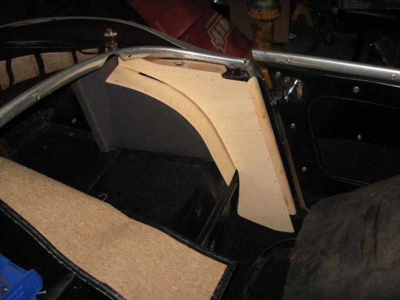

i have new quarter panel wooden pieces but have a question regarding the interior side of the spare tire opening. i can see a couple of factory bendable attachments that seem to hold an upholstered panel in place againt the interior side of the rear bulkhead. my car did not have any panels in place in that area. can someone tell me what is in that area and if a picture is available that would be nice!

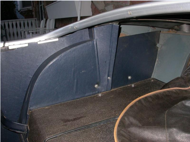

Maxwedge,
It should look the image below. The only thing on the back wall is the rectangular frame (Inside the trunk) that holds the tire carrier upholstery in place.
Duane

thank you, duane! i have the small side pieces...in poor condition. so i will just cut new pieces and upholster. thanks again.
