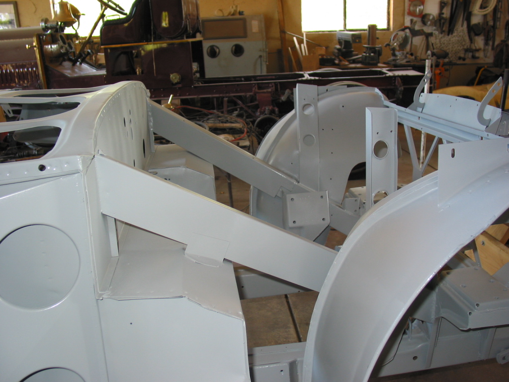

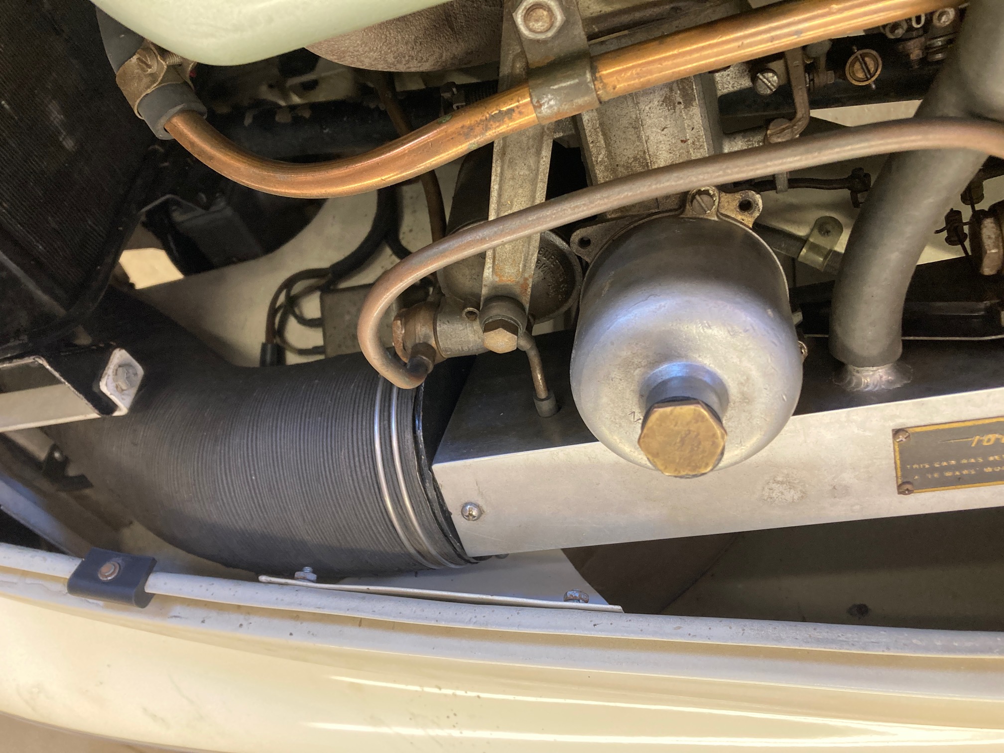

Here's a shot showing the vertical bracket with its slight bend outward to accommodate the CAB. On the top goes a piece of bent sheet-metal to re-align the bracket with the shroud. Unfortunately, it's not readily visible behind the CAB and I don't know of any vendors that offer it, though BCS would be worth a shot.
