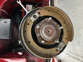

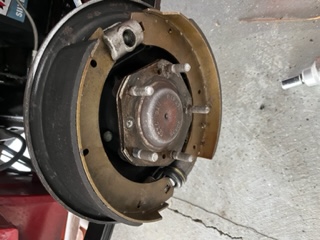

Thought I would post a picture of the right rear brake set up. I have read several times to make sure to have the shoes installed
correctly and believe these are done right but with this on going problem figured might as well post a pic to confirm.
I am going to start trouble shooting the new brake cylinders sourced from Moss to make sure there are no issues with them. That's
when my problems started after replacing the left rear. Shows my wrench used to adjust the brakes

They look good,,,, exactly like mine. I think we talked about this, but you checked the shoes against the drum to be sure the arches match?
