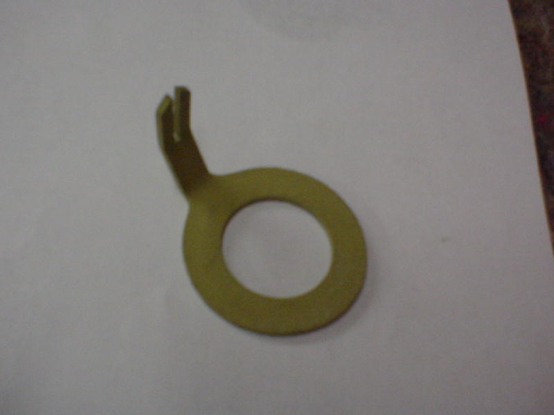

This is the piece that I believe is supposed to hit the 2 little fingers and cancel the turn signal. Problem is that it sits about 1/2 inch from them. It would probably hit them if the upright part was bent back to being straight up. Or should it just be bent from the bottom until the top part hits the fingers? Or is this even the correct piece? This piece is completely different from the one in the pictures you gave me to look at.
Thank you again.
Sopp

BUT, is it the correct piece? Is it the correct shape? Am I missing something else? The top end of this piece is about 1/2 inch away from the fingers that cancel the switch. Do they need to be bent inward so that they will touch the fingers? I sure wish I would have taken some pictures 12 years ago when I took this apart. Of course I din't plan on 12 years passing before reassembly.
Thanks for putting up with all these questions.
Sopp
