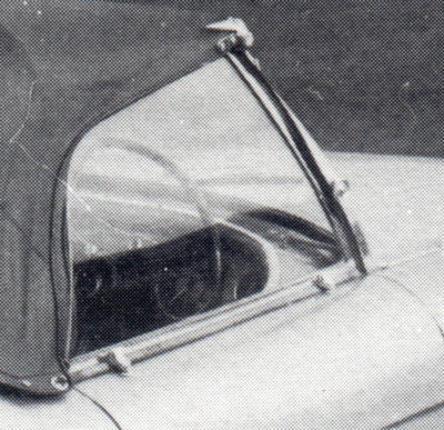

For some reason, a set of these early screens came with my first BN2 in 1959.
As far as I know, the screens would need to be tucked in each time that you closed the door. The top flaps were the same as with the later BN1, BN2's. It was easier to reach the inside door latch if the tops front hold down snap was released.
The top front of the screens always bowed out at speed & leaked a lot. I made a couple of extension tabs that fit under the top latch knobs to keep the top of the screens from bowing out.
I actually liked them better than the later canvas flap arrangement.
I have attached the only pic I've been able to find.

Thanks Dave Russell,
The photo shows what I have come across, that the rear of the perspex does not fit inside the cloth, even standing still!, might be to vent the heat out of the car, or its an early version of flow thru ventilation
thanks also for the comment about them flexing outwards while on the move
