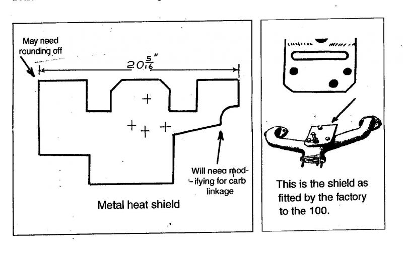

From Norm Nock's book. He used this one.
http://www.britishcarspecialists.com/~britisj3/publications.php
Drawing is to scale - enlarge on copier to specified size and cut from aluminum. Fit heat insulation on lower surface with screws:
Also contact Joe Curto about his float bowl "coozies" insulating socks. I'd also insulate the fuel lines passing near the exhaust and across between the carbs.
