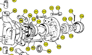

I'm repacking and shimming my front wheel bearings but am a little confused about how the bearings and spacer come out of the hub.
The hub is off, sitting on my workbench. The outer bearing came out easily when I gently tapped it from the inside with a drift. But the spacer won't follow it out because it is held in by the outer bearing race in the hub. Does that race need to come out in order to remove the spacer or is there something in all that nasty old grease that I can't see that's holding the big spacer in there?
The shop manual is unclear about this process (to me, at least) so I figured I would ask the Collective:
Should the spacer follow the bearing out or does the race need to come out first?

Jonathan, the distance piece ( spacer ) is basically trapped in there by the bearing races. But having said that it might slip out from the back side of the hub, the big end. I can't remember if it does for sure or not. I knock the races out with a brass drift about 6 to 8 inches long. If you clean out some of the old grease you will probably find that the inner surface of the hub is notched about where the race sits on a machined ridge. Those notches are there so the brass drift will sit unto the edge of the race so that the race can be punched out. If you have it this far apart I will recommend that you take it all apart so that you can clean every piece. When I have it apart as far as you have, I don't trust to just pack in more grease and reassemble. The chances of getting dirt and grit in there is too likely. I wash everything in a bucked of gasoline with a stiff brush then blow dry with compressed air. But don't spin the bearing when it has no grease. the shims are important so don't leave them out.

Assume by "spacer" you mean the distance piece - item 121 on the Moss "Front Suspension" page.
I just looked at my old drum brake hubs, distance pieces and swivel axles. The distance piece withdraws through the inner race. The inner race is 2" ID; the distance piece is 1-5/8" OD.
The shims (item 122) are located between the small end of the distance piece and the outer bearing.
