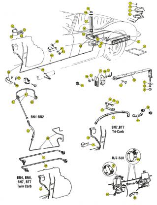

On my car the fuel line connecting the forward carburetor to the rear carburetor is a rubber hose that is hose-clamped to the banjo fittings on each carburetor. I've seen other Healeys with a lovely copper line running from banjo fitting to banjo fitting. The Moss catalog indicates that the hard line should be brazed to the banjo fittings.
The question I have is this: how hard is it to do that brazing? I've worked on copper pipes (domestic water supply) in the house with great success. But before I start messing with the banjo fittings and propane torches I figured I would ask on the Forum if anyone has advice about how to proceed. This project is primarily an aesthetic one but it is something I have been pondering for a while. (Obviously, I will do any torching far far away from combustibles...)
I'm talking about #62, 63, & 64 in the diagram.
