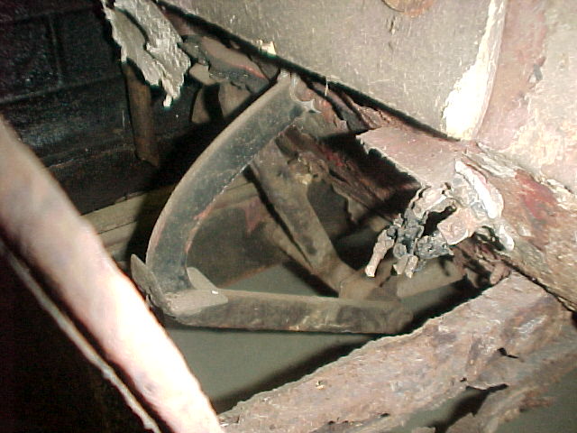

18.jpgAs you can see the clutch peddle has been depressed the brake hasn't.
They move along way and when the original down pipe, has only one, is fitted there's not much room between the metal peddle sealing plate and the pipe.
You can see the upper edge of the plate has been bent, because it touched the down pipe ? may be,.

View attachment 40952As you can see the clutch peddle has been depressed the brake hasn't.
That's with the original downpipe? Now I don't feel so bad; but I'm not going to bend my sealing plate to prevent it. Considering using some ball-pein persuasion on the downpipe, though sometimes that can cause a 'ticking' noise in the exhaust. Have heard from others that some of the re-pop downpipes are incorrectly shaped, though.
