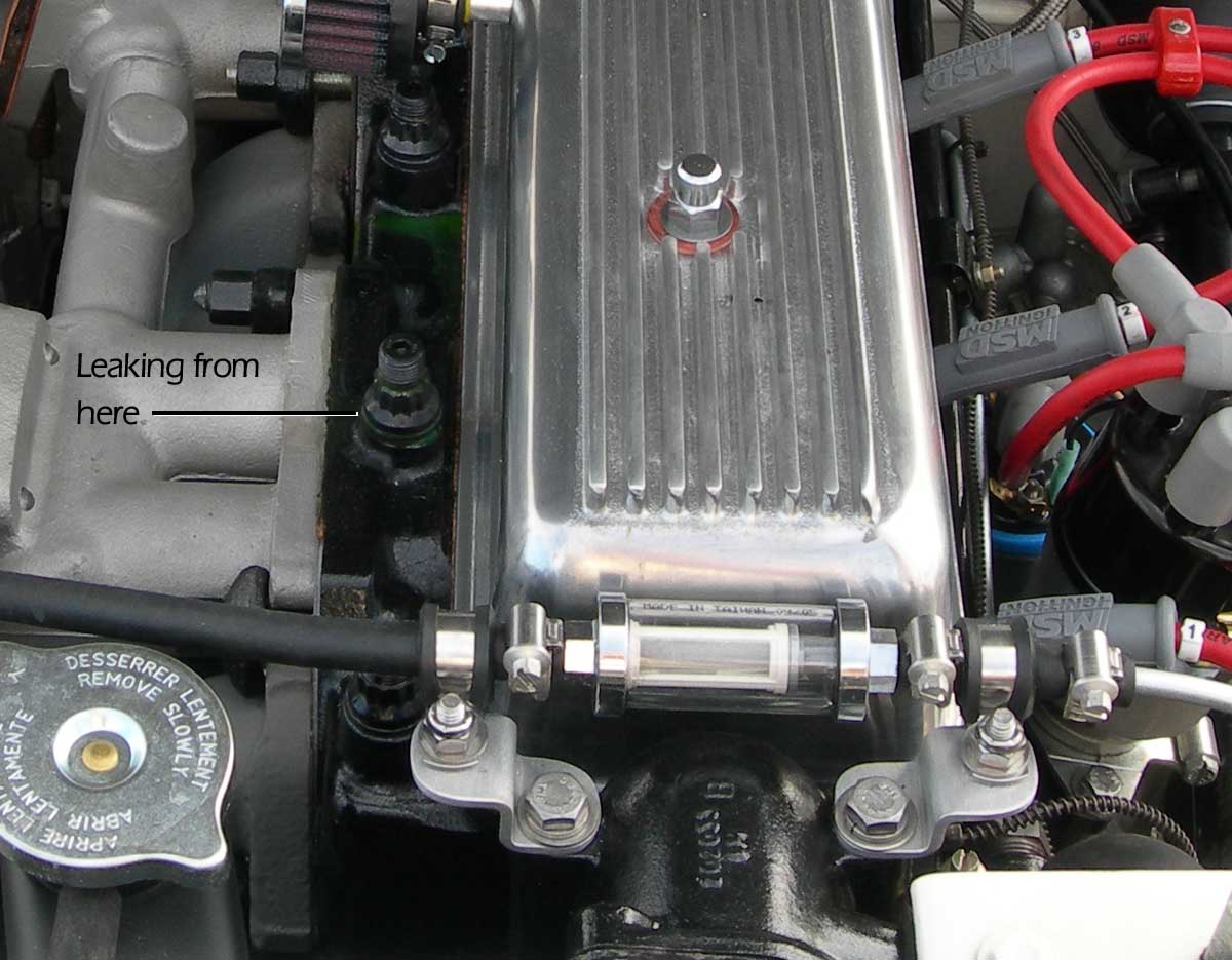

I've got about 200 miles on the new engine (TR3), and I now have coolant that is leaking out of, and/or around, the head bolt on the intake/exhaust side between #1 and #2 (see attached photo). I'm assuming that it's a blown head gasket, but before I do anything stupid (it may be too late for that) I would like to ask if anyone has encountered this before.
I used a new copper head gasket (sprayed with copper sealant) and new ARP head bolts with their assembly lube on the threads, washers and bolts. I torqued them in the proper sequence in 3 steps...30, 60, and finally 90 ft. lbs. The Haynes manual (it's the only one I have) lists the head torque at 100 to 105, but ARP recommends 90 -- someone said torqueing with assembly lube at 90 is equivalent to a "dry" torque at 100 ft. lbs. And someone else who works with me at RENNtech said don't do a 3 step torque -- go straight to 90 (went through 3 head gaskets on the Sentra before ARP told him to torque it in one step).
Now here's the problem. I am NOT a mechanic, so all I know is what people tell me. And so far 5 people have told me 5 different things! If I looked up 100 more opinions, I would have 105 different ways to do it -- can you feel the frustration?
That being said, I'm still open to advice...thanks for letting me vent.
