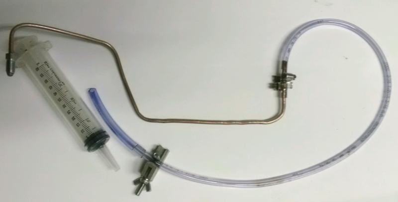

I had a similar situation with my Fiat 124 MC which did not resolve until I hooked up the recirculating bleed pipe. This allowed me to pump the air out of the MC. The clear tube goes in the reservoir. The clear part allows you to tell when the bubbles stop coming. Then the mc should be air-free. Then proceed to bleed each of the wheels.
I like to use the syringe shown to pull the fluid out through the calipers, being careful not to allow air in past the bleed screw threads.

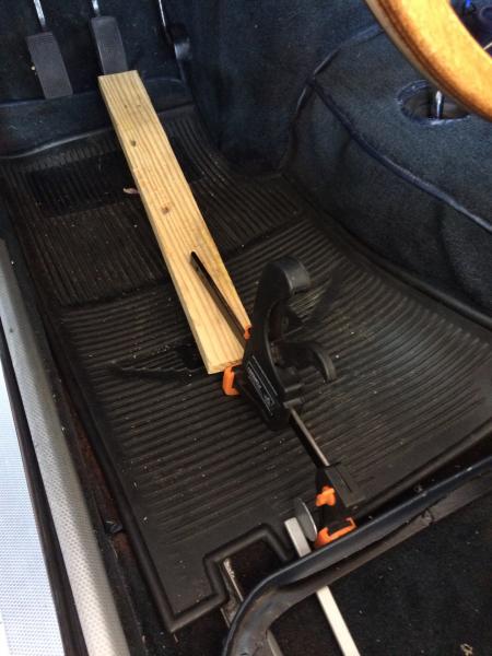

I can't remember where, but I read somewhere (perhaps on this forum) about a rather easy fix worth trying if the pedal travels too far or if you have to pump several times to get a hard pedal. Just pump it up, keep it depressed and lock the pedal in the depressed position with a piece of wood or something similar. Let it sit over night and when the pedal is released the problem is fixed. I know it sounds like magic and I can't explain why it works, but it certainly did on my car. No more pumping, it brakes after an inch/a couple of centimeters of pedal travel or so.
RE: Novamonte's comment from Apr 2018.
I Rebuilt my front calipers several months ago and had my wife help me bleed the brakes. No matter how many times we did each of the four corners, the pedal always had 2" of free play on the first push before you could feel resistance in the pedal. The brakes worked fine and after several pumps, the resistance came at about 1 inch.

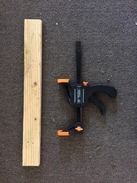

Two days ago, I finally decided to give Movamonte's idea a try. Used a piece of 1"X2" and a reversed clamp to lock the pedal in the depressed position against the seat frame. The next morning, I measured the free travel and it is now 1" and on the second pump, 1/2". I can't for the life of me understand how this works since I never opened the bleeders but it obviously did something to reduce the free play. I haven't noticed any change, good or bad, in the braking, just less free travel of the pedal.
Anyone know why this would work?
