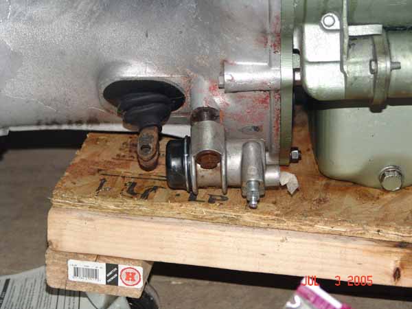

Do you have the flex hose to the slave installed in the correct hole? It should be coming in from the rear not the top. It's a common mistake as the bleeder screw is shipped in the box in the wrong hole. If this is backwards it's almost impossible to bleed. I'll attach a photo of the correct way.
Hoho. never thought of that. What a bummer that would be.
