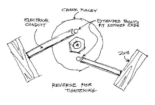

I used this setup to lock the crank - in combo with the above socket with a 4 ft cheater on a Harbor Freight 3/4" breaker bar:
