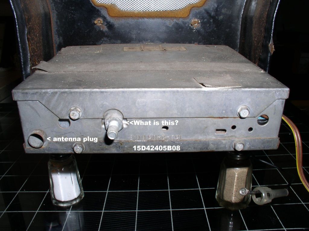

Okay, got the pictures posted here of the radio. There are a few areas with numbers and I highlighted for easier reading. But the bottom part of the radio also has a number inscribed I did not catch in time but is noted here as: "15C42402B0", for whatever that may be worth.
I know and accept that I have limited electrical know-how of electrical design, but in terms of "isolating" the ground (knowing the car is now negative and "assuming" the radio is positive), the radio along with the antenna, I know how to construct so that the radio and antenna is "floating" or isolated from the chassis. Even if I made a kind of ground (block of metal installed but not coming into contact with any other part of the chassis), could this theorically work, or am I really up the creek without an inverter (assuming the radio is positive)?
The current facts are:
My car was changed from positive to negative but never completed. Everything now is pretty much converted (tach, generator, fuel pump, etc.). The radio was already in the car but never hooked up when I bought it, so I have no idea if it is positive or negative, or even if it is ever going to work.
So, what would be nice at this point is to determine from viewing the pictures below if this radio's polarity setup is easy enough to identify just by looking at it. It is my understanding this radio came later on so maybe my chances of this radio's polar setup being negative is good. If not, then research is needed and I can start searching with the numbers shown.
If the radio happens to be of a positive setup, then what about my idea of grounding above? Any stabs?!
PS - The exposed screwthreads on the back (captioned as "What is this") is designed for support via using a bracket. (Thanks a bunch to Steve, Ray and everyone else here for their constant input).

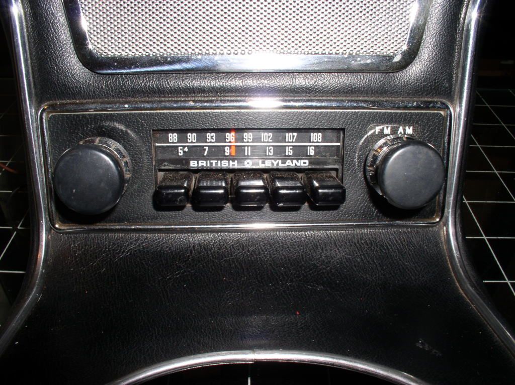

Bob, I see my model right at the top of the list.
Not too bad price wise. I even found a place in Jersey that works on vintage car radio installations. Maybe when I'm ready, I'll check them out or continue searching on the internet for another and take it from there.
And if it's a negative setup, then I think I can hook it up myself, but I'll cross that bridge when it comes. In fact, all I need to know is its polarity. If I have to pay $22- for that answer, then so be it. But I am in no rush so I'll just be patient for a while.

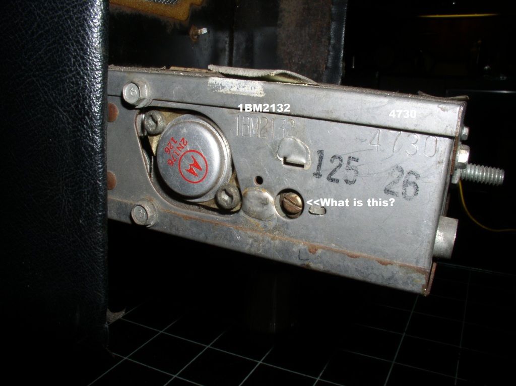

Hi Paul,
That screw is likely the AM antenna trimmer which was adjusted for best reception after install. The radio is probably from an MGB or Triumph around 1972 so would be -ve earth.
Take off the lid, there may be a circuit diagram stuck to the underside. You may also see a date code on some of the components. The Motorola transistor on the back has a date code 126 but I don't recognise it. Normally they are like 5812 for 12th week of 1958. The bolt sticking out of the back would have had a metal strap going to the chassis to both ground the case and hold it in.
Andy.

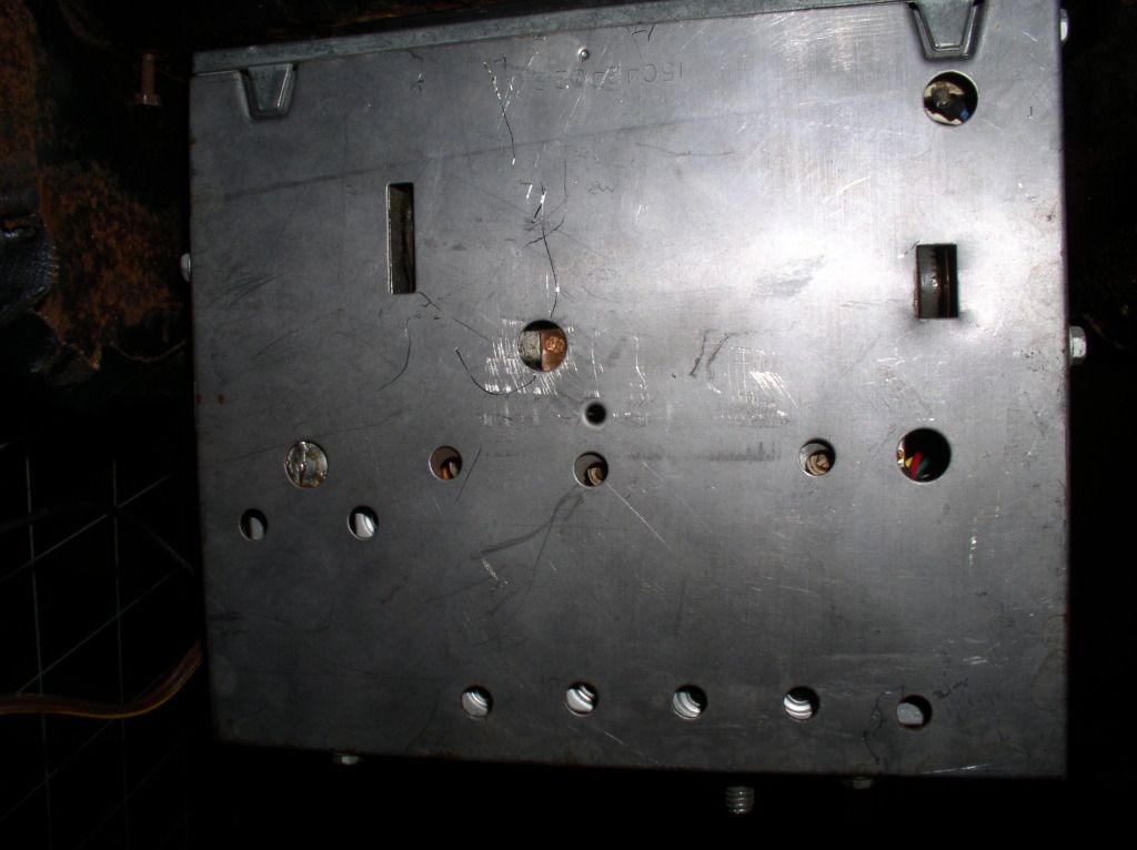

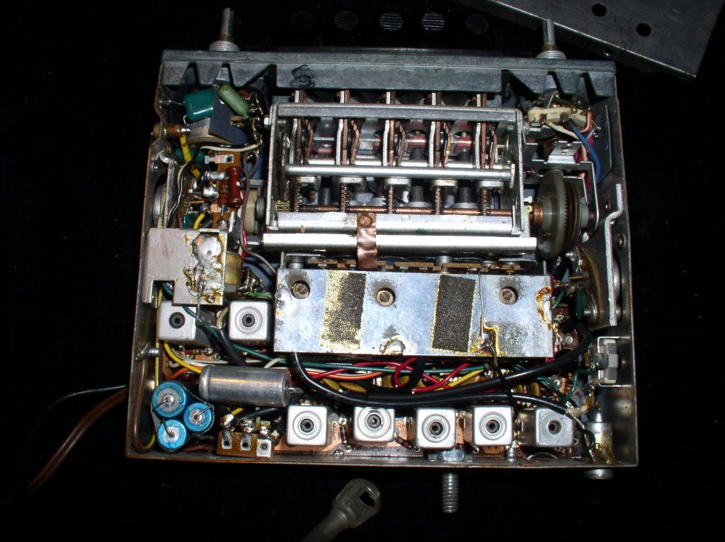

AH and Forum,
Finally took photos of top and bottom interiors of the radio. Still no signs of switches to cross from positive to negative or vs. Noticed filament to bulb is still good, if that's worth anything. Nothing appears to be fried or tampered with, but that's just my guess.
Looks to me this radio was designed for negative setup.
Anybody care to make a further guess?
Thanks,
Paul
Re: BJ8 Tachometer, "sparking"
Well near that small plastic socket is a + and the typical Electrical ground symbol.--Fwiw--Keoke

Hi Paul,
Your radio is very similar to the Motorola Sapphire fitted to VW's in the early 70s which were negative ground. Here is a pic of a VW radio, if you study the PCB at the top enough you'll see slight differences.
Here is an article about an early 70s BL AM radio which by the circuit diagram has a floating ground and is (I'm pretty sure) positive earth. https://www.spridgetguru.com/TA0037.html
Given that you don't have any firm info on which polarity it is, I'd pay the money to get the schematic as wiring it up incorrectly will cost a lot more than 22 dollars to fix. Post a pic of the wiring diagram if you get one, it should be fairly quick to establish the polarity.
