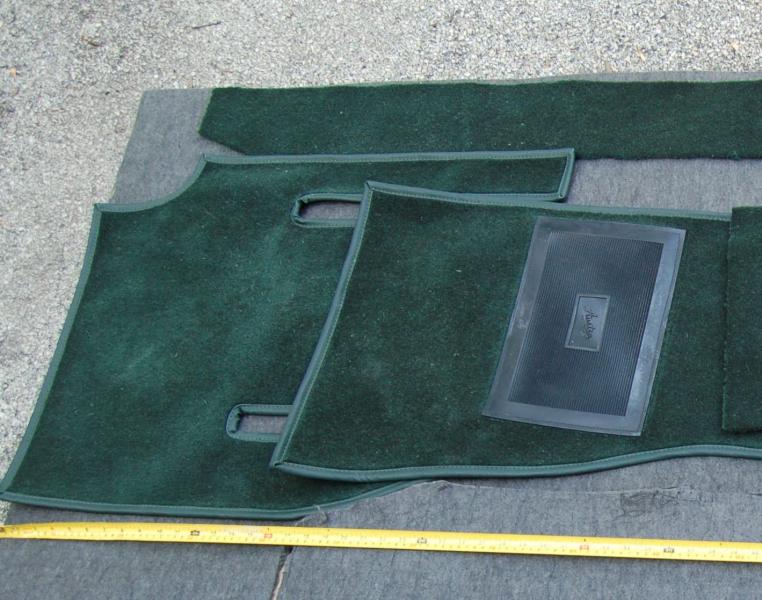

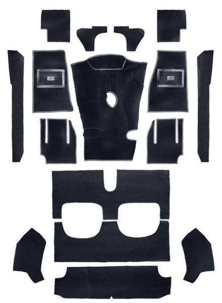

All the originals and the good carpet kits come with the cutouts for the rails.
The following picture of the BJ8 kit is an example from AH Spares:
Picture from Richard Berman's site:
