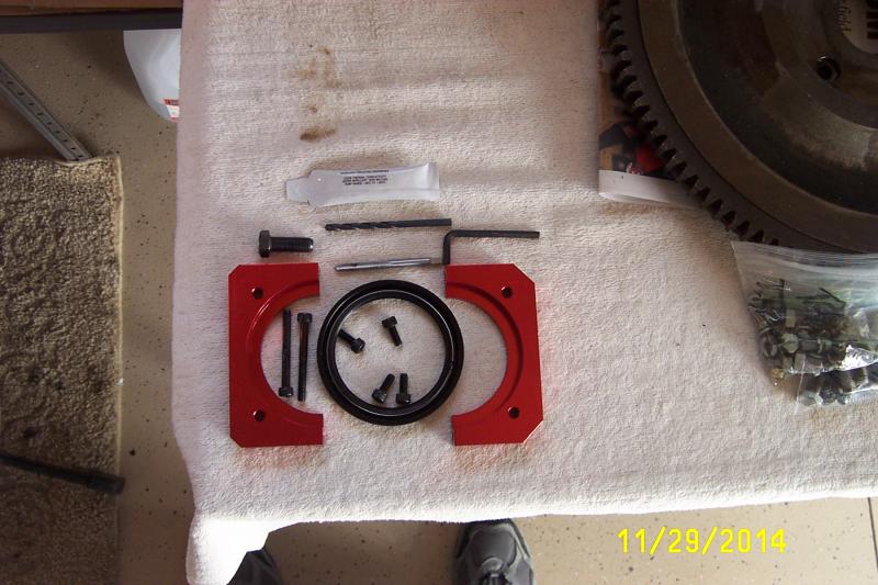

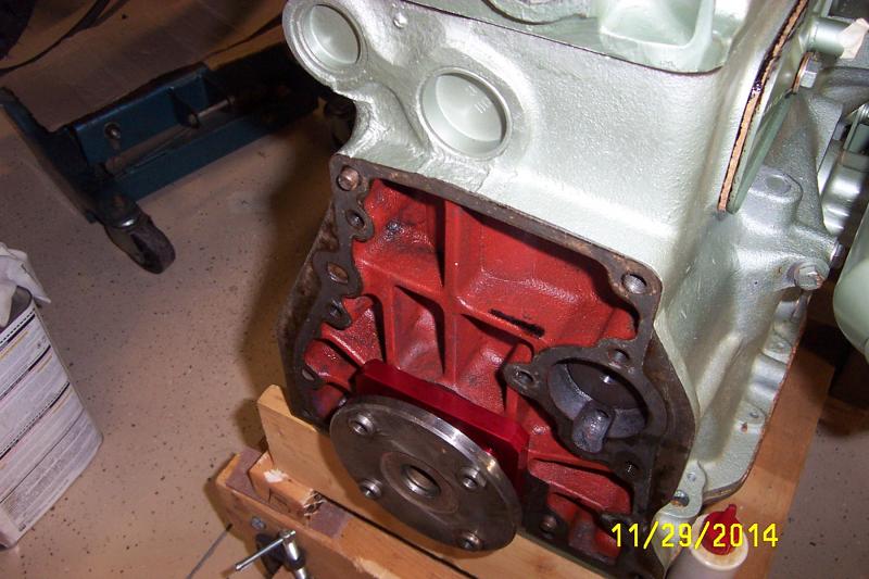

DONE--Re: BJ8 rear main seal kit - is it necessary and worth the risk to install?
Seal installed with no installation issues. Thanks to all who said "while you are in there" to go ahead and install the seal. Go the seal from British Car Specialists. I believe the seal is the Denis Welch unit as it has the square housing. Hopefully we will see how it works in a couple of months. Thanks again to all.
jjs64bj8
Good job, you will be glad you did it ! The scroll seal design wasn't too bad for 1955 technology. If all clearances are perfect it didn't work too bad but did drip. With any wear at all on any of the surfaces and you have a real leaker ! Good luck
