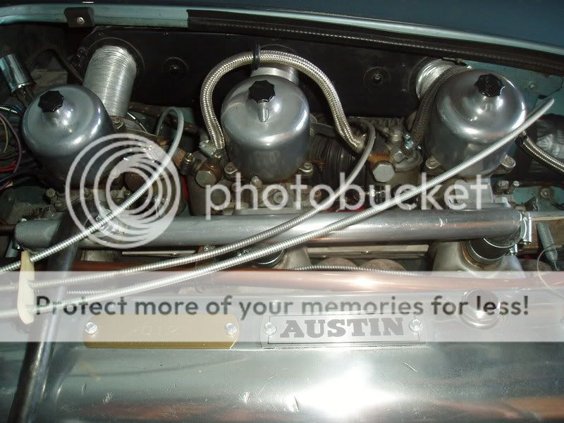

Hi Ed I have 3 HD8 SU, I am not sure where I got the air intake box from. It fits in under the wing just in front of the air intake. It is 3 inches deep, a plain back, a plain front with the 3 holes drilled in it, it relies on air finding its way into all the S/S mesh holes all around the outer edge, the interior of the box is filled with foam. It works fine. Hope this is of some help.
I was told it could be from an XJ or XK but not confirmed?

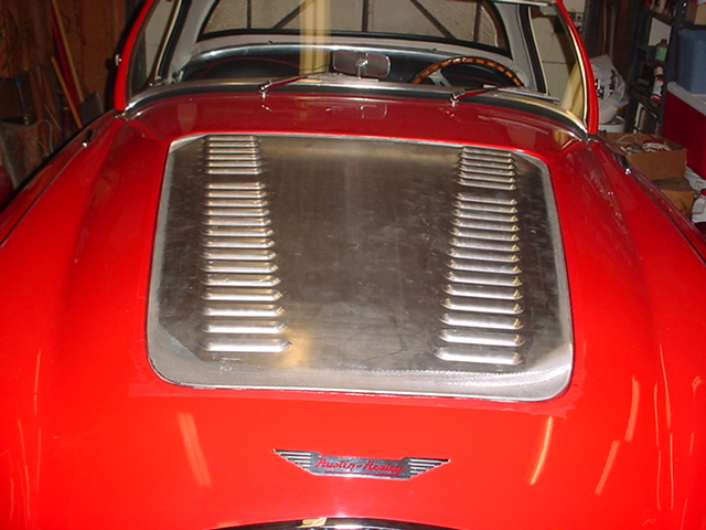

I just sprung for a new 100M aluminum bonnet, already louvered. It's in the paint shop now. I'm skipping the obligatory leather strap, at least for now. Pic attached.
