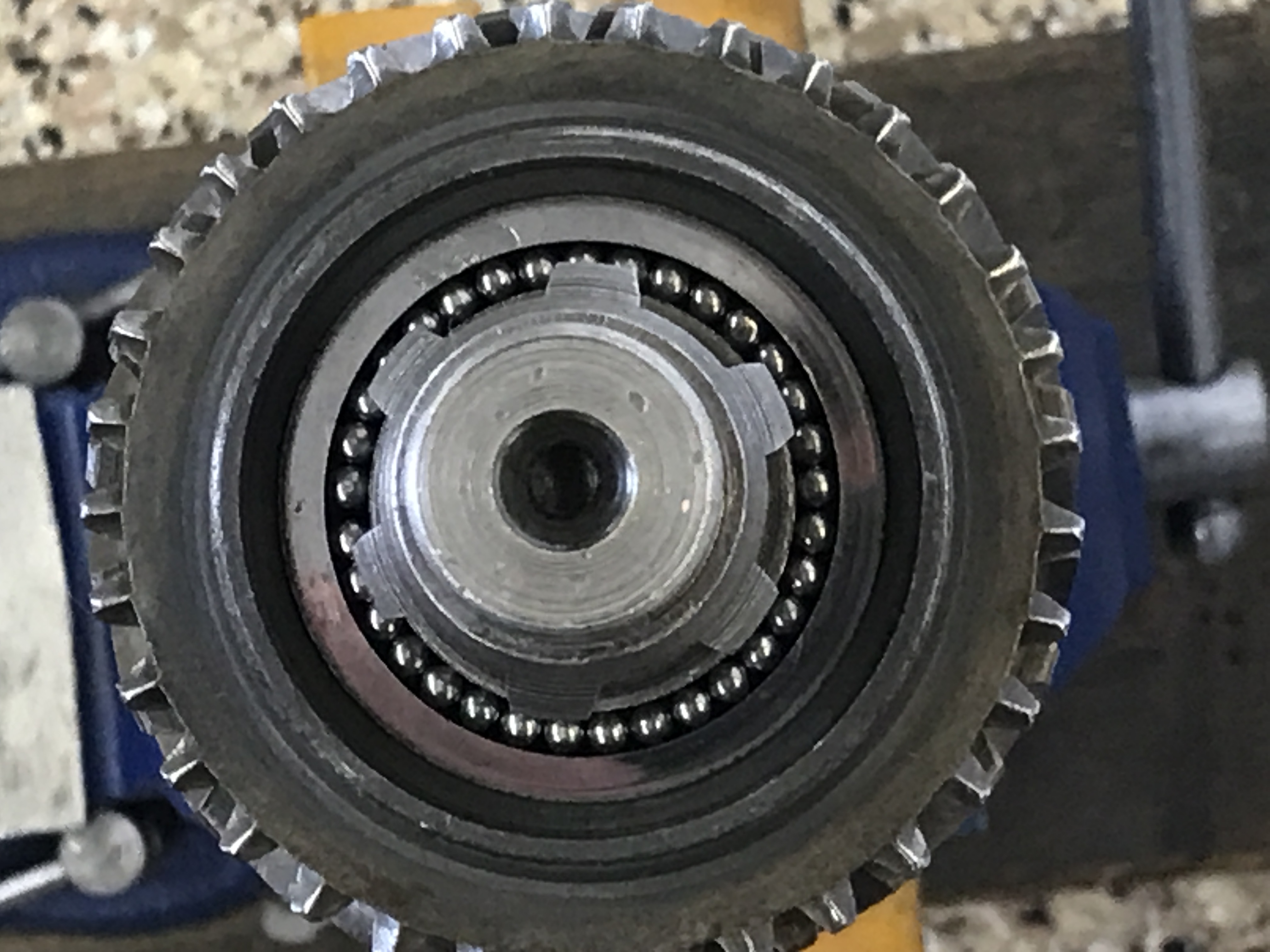

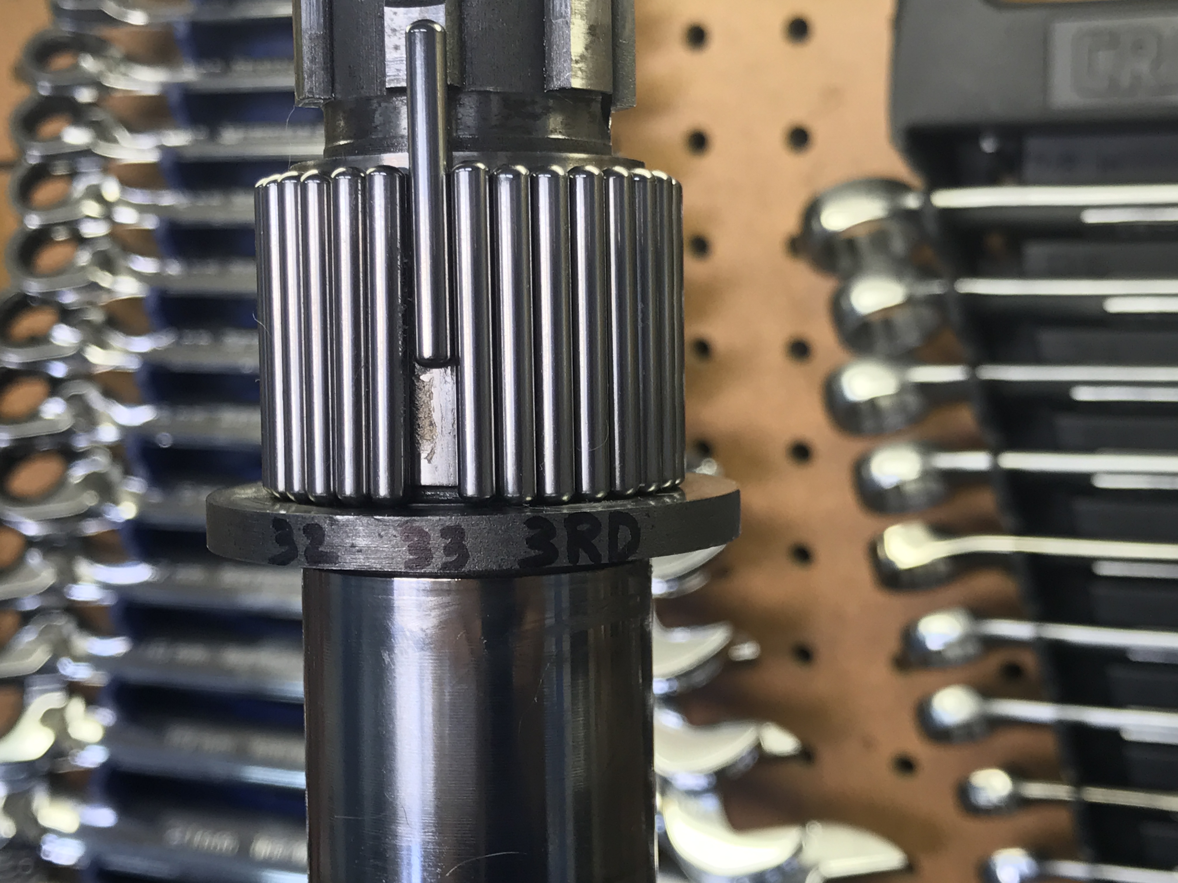

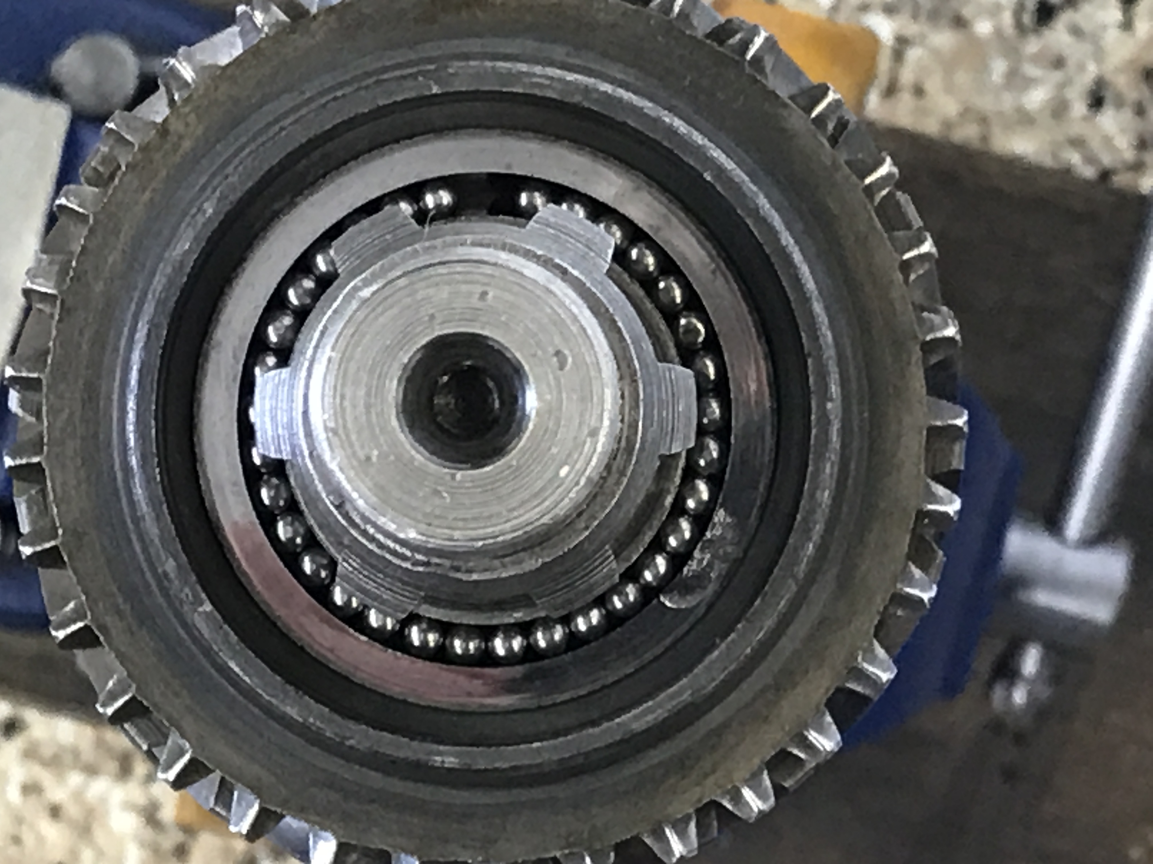

I've dismantled mine and found 2nd gear has 33 rollers and 3rd has 32 rollers.
I noticed 3rd gear had a gap in the 32 rollers, so I added one more, total 33 now. Put the locking plate on and the gear spins freely.
Why doesn't 3rd gear have 33 needle rollers?
If it ain't broke, don't fix it, or did something change down the line and 3rd should have 33 needle rollers?
