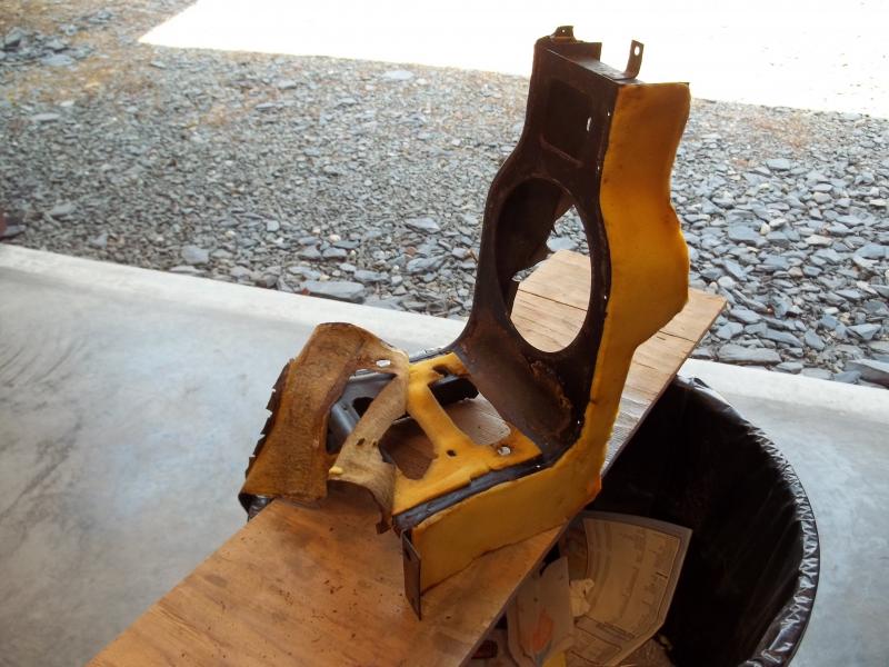

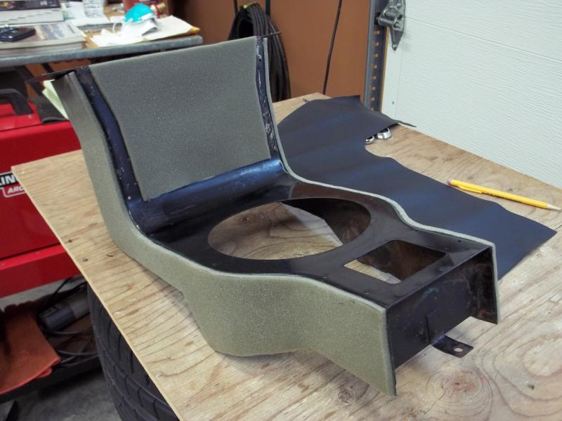

010.jpg007.jpg011.jpgHere is the correct way to install the foam. Modern vinyls are a bit more difficult to install and do not have the original stretch like the Ambla, but can be done to look correct.
Carroll
