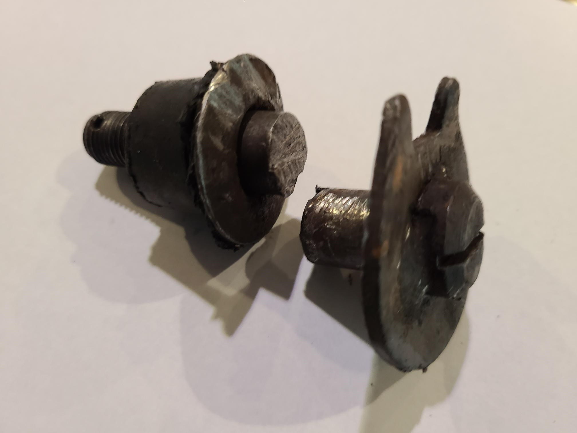

Success :smile: !!! Thanks for the pickle fork tip Bob...I owe you a beer. No idea why i didn't think of it myself. You know what they say...it takes a village. A couple of well placed bashes w/the pickle fork made enough space for the sawzall w/a short blade on it. Then finished the cut by hand. Phew :smile:

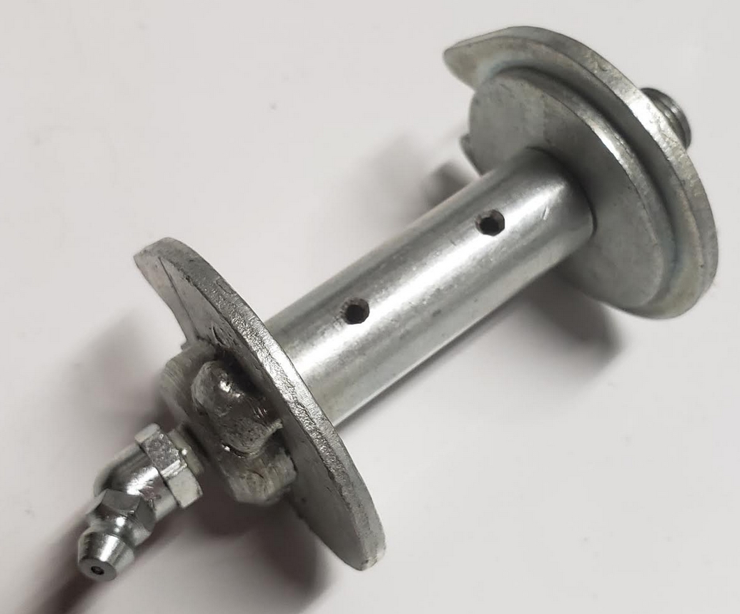

If you use the urethane bushings, be sure to grease the pins with some waterproof grease - will delay the onset of squeaking.
I went the whole hog and drilled mine for grease fittings:
If you don't use urethane bushings and the bushings have a steel sleeve, use anti-seize. If the new bushings don't have a steel sleeve, do not use grease, the rubber flexes.
