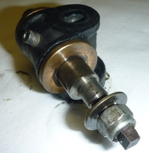

I'm using the Cape International offset trunnion setup, so there's no driving the pin through. It's easy to adjust without taking the upper suspension apart. Recently was readjusted as part of a comprehensive wheel alignment.
When I bought it, the bronze bushes didn't fit all the way into the recesses in the upper trunnion; the machinist who fixed that also machined the lubrication groove visible in the eccentric pin. All that took it up to $250 or so total at the time. Pretty sure it's not worth the extra price over the delrin bushings. Also, it may not give as much offset as the delrins. The pin rotates easily in the bushings.
The allen screw shows the position of the 10-32 grease fitting mentioned above.
