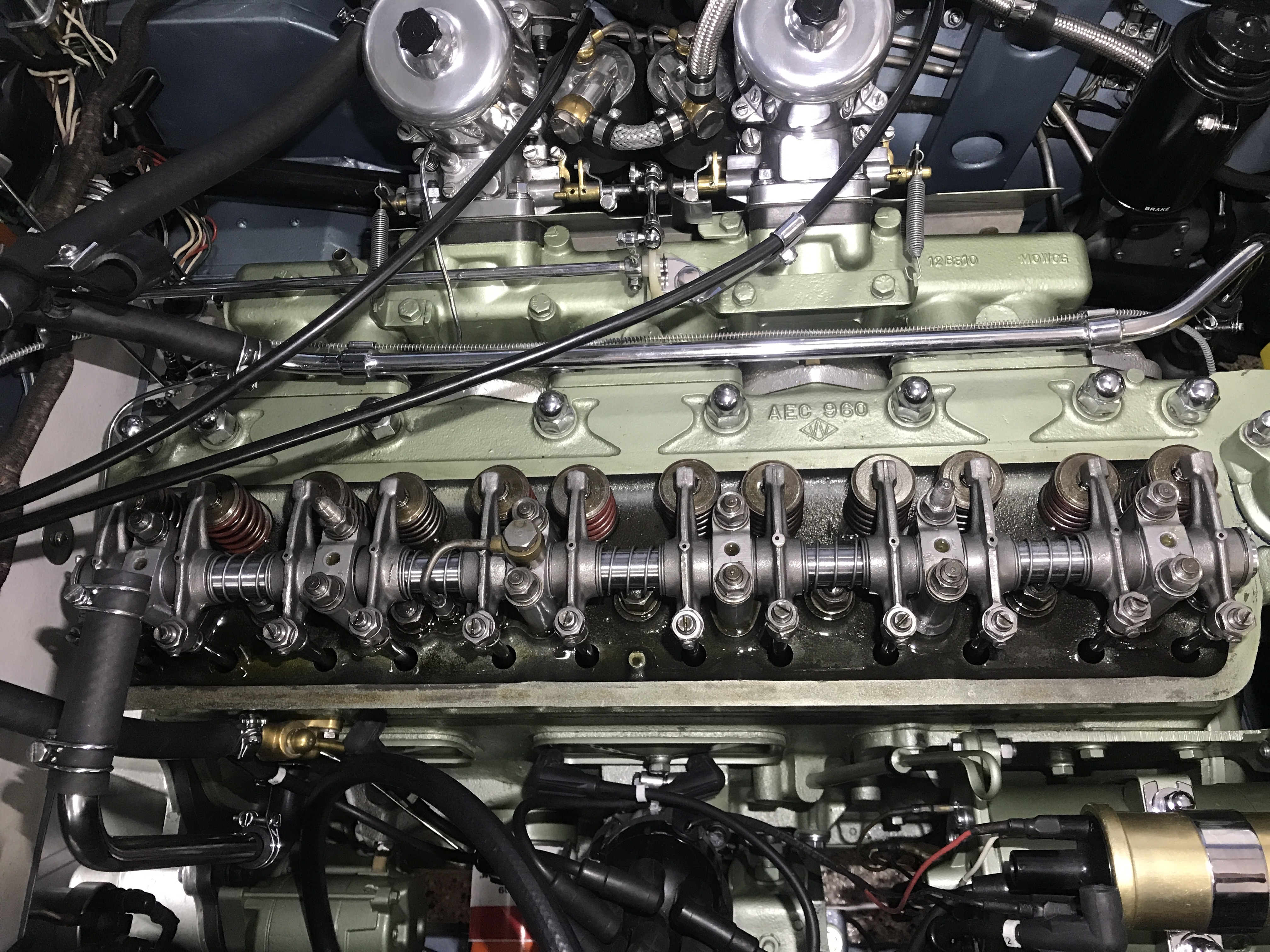

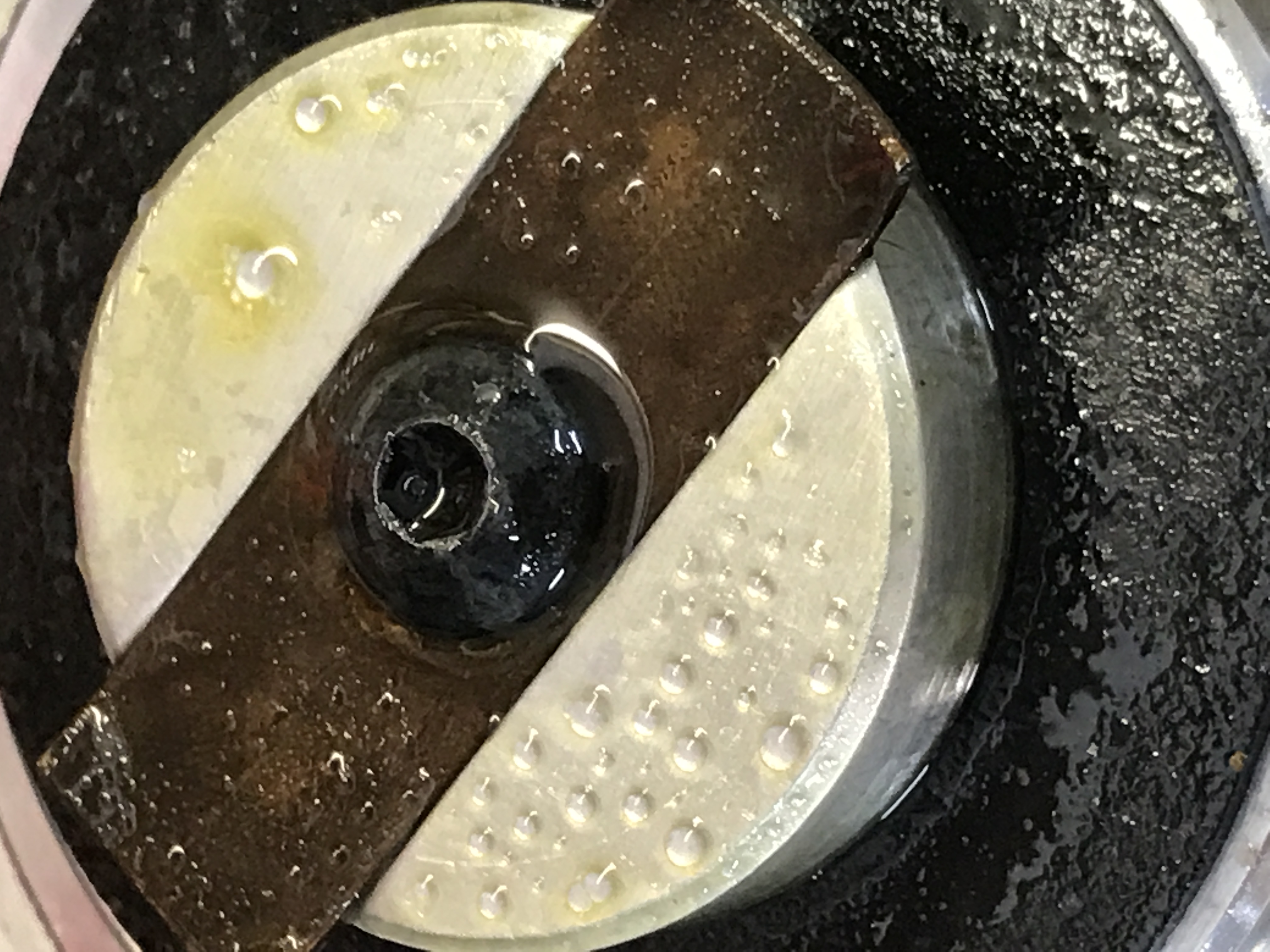

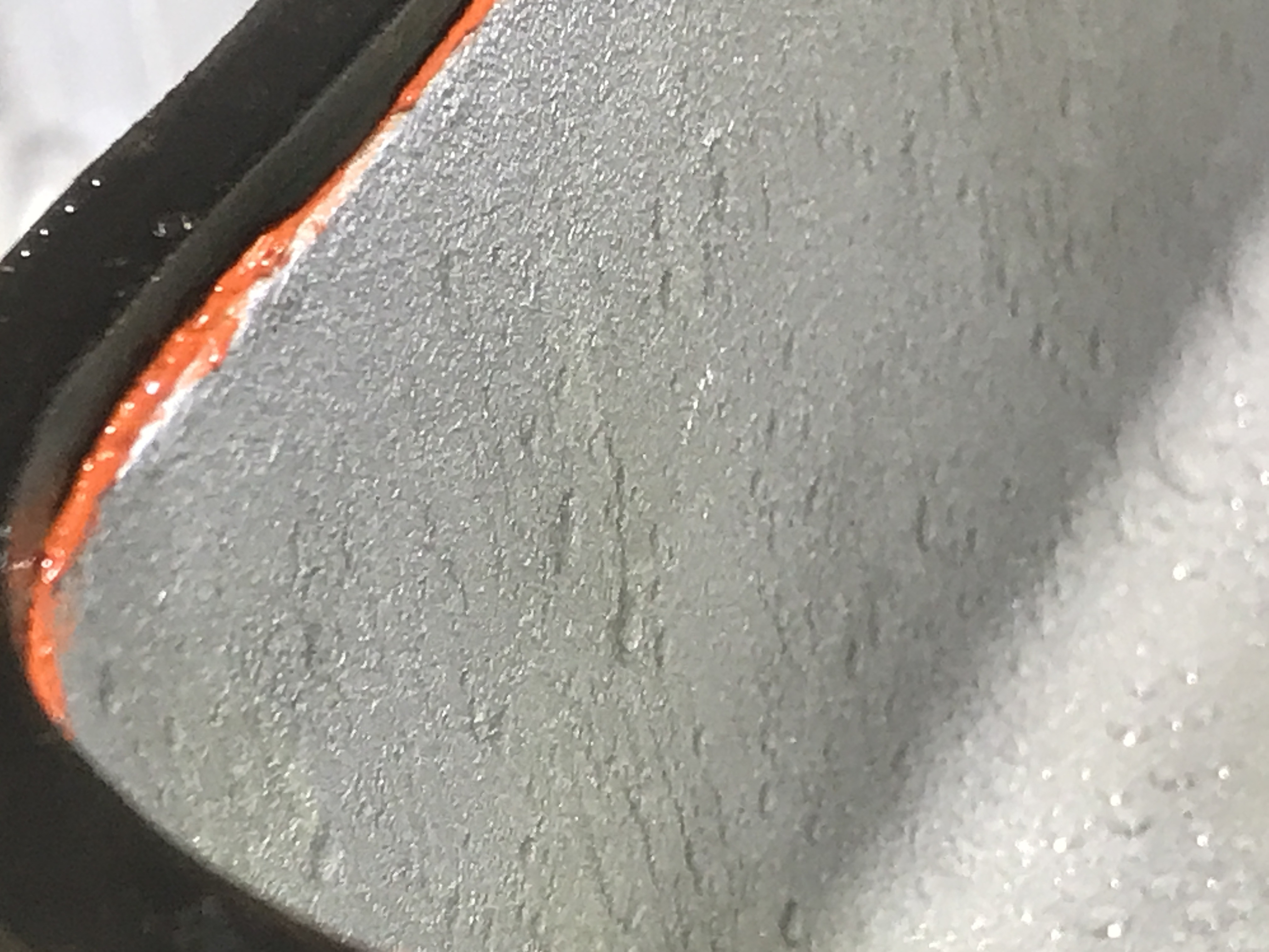

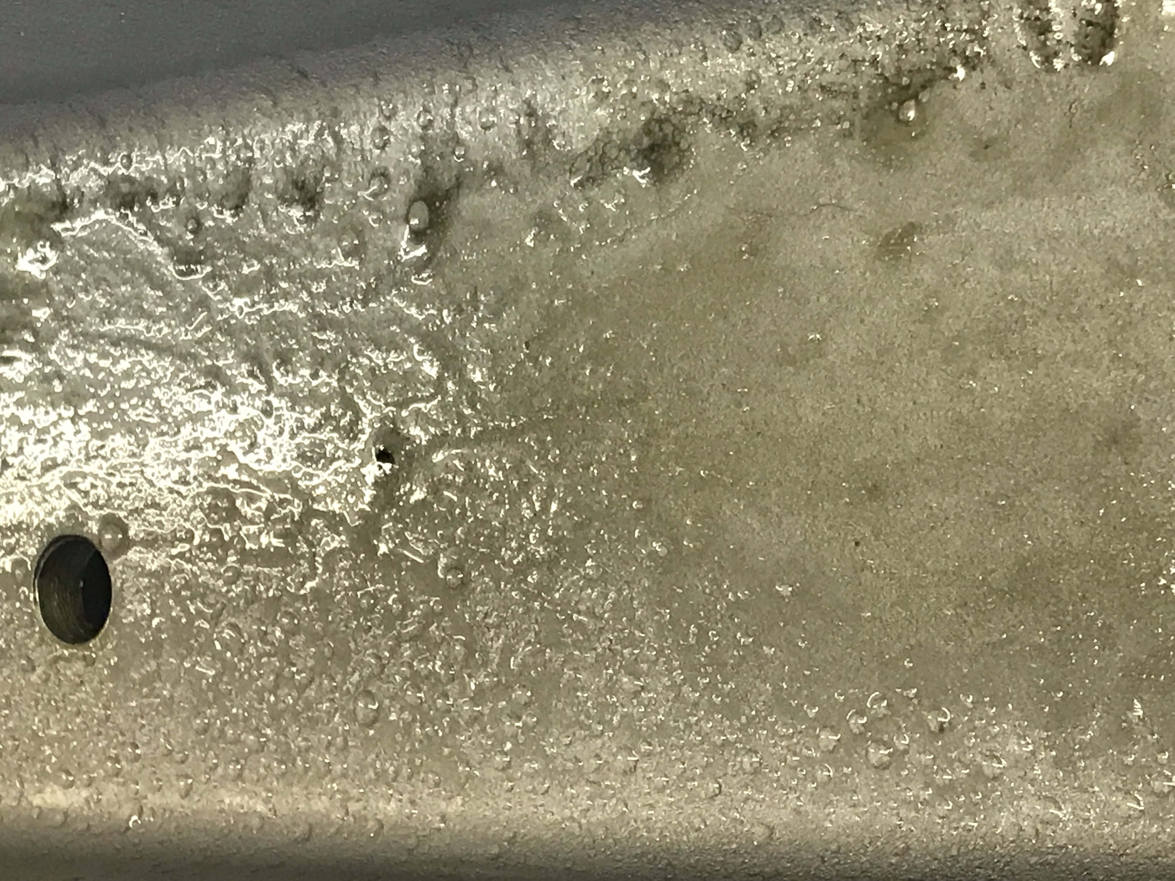

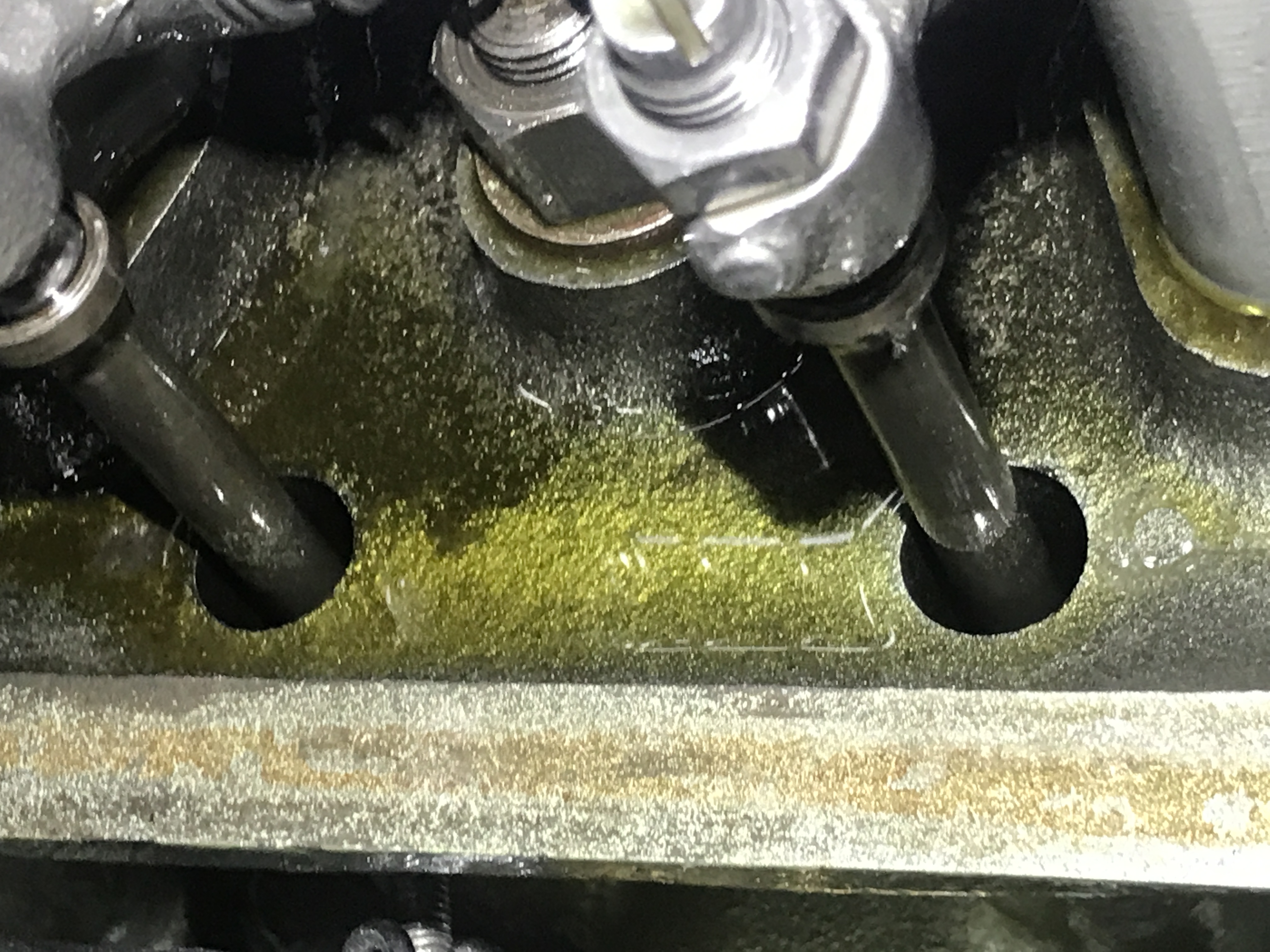

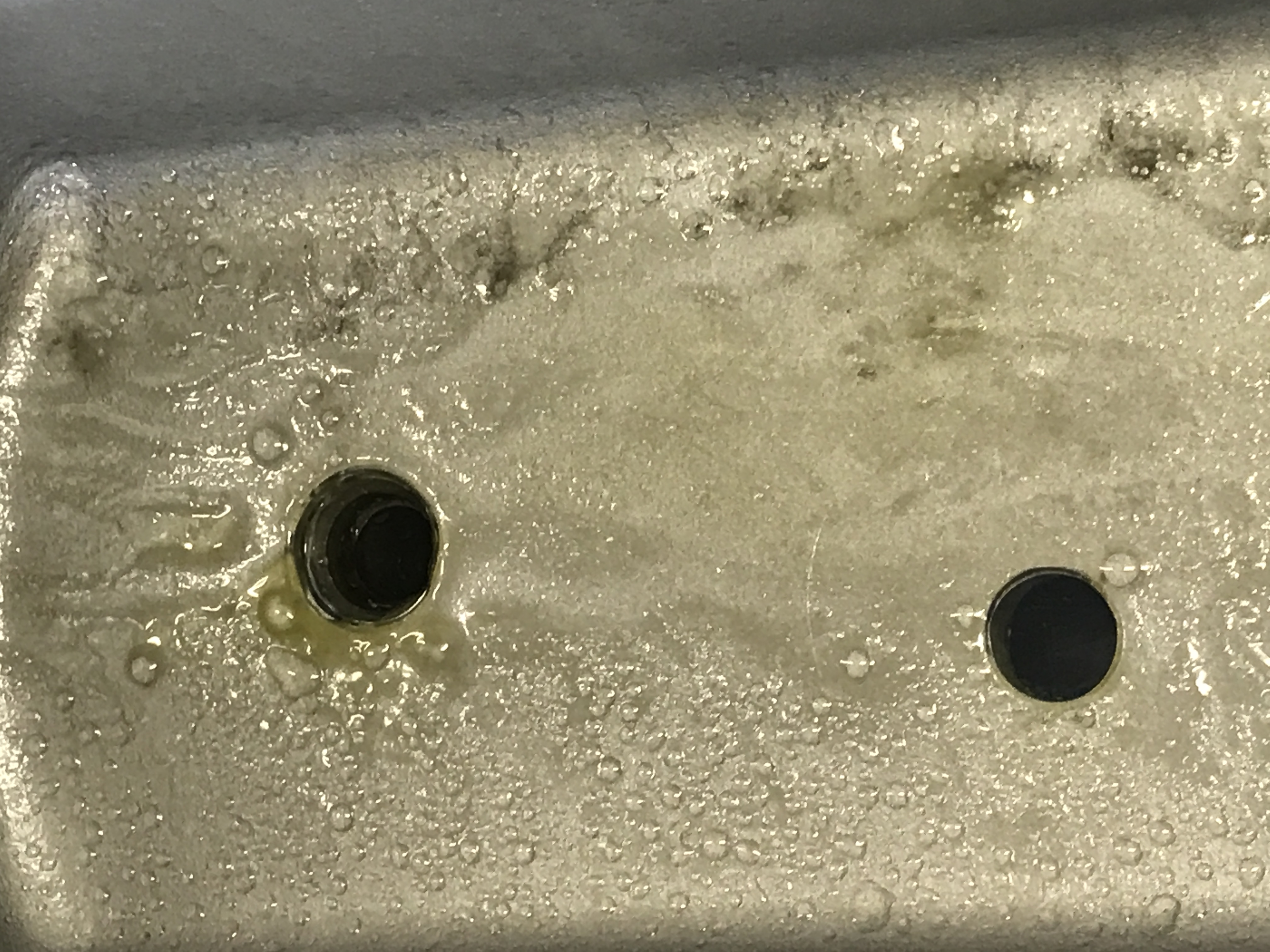

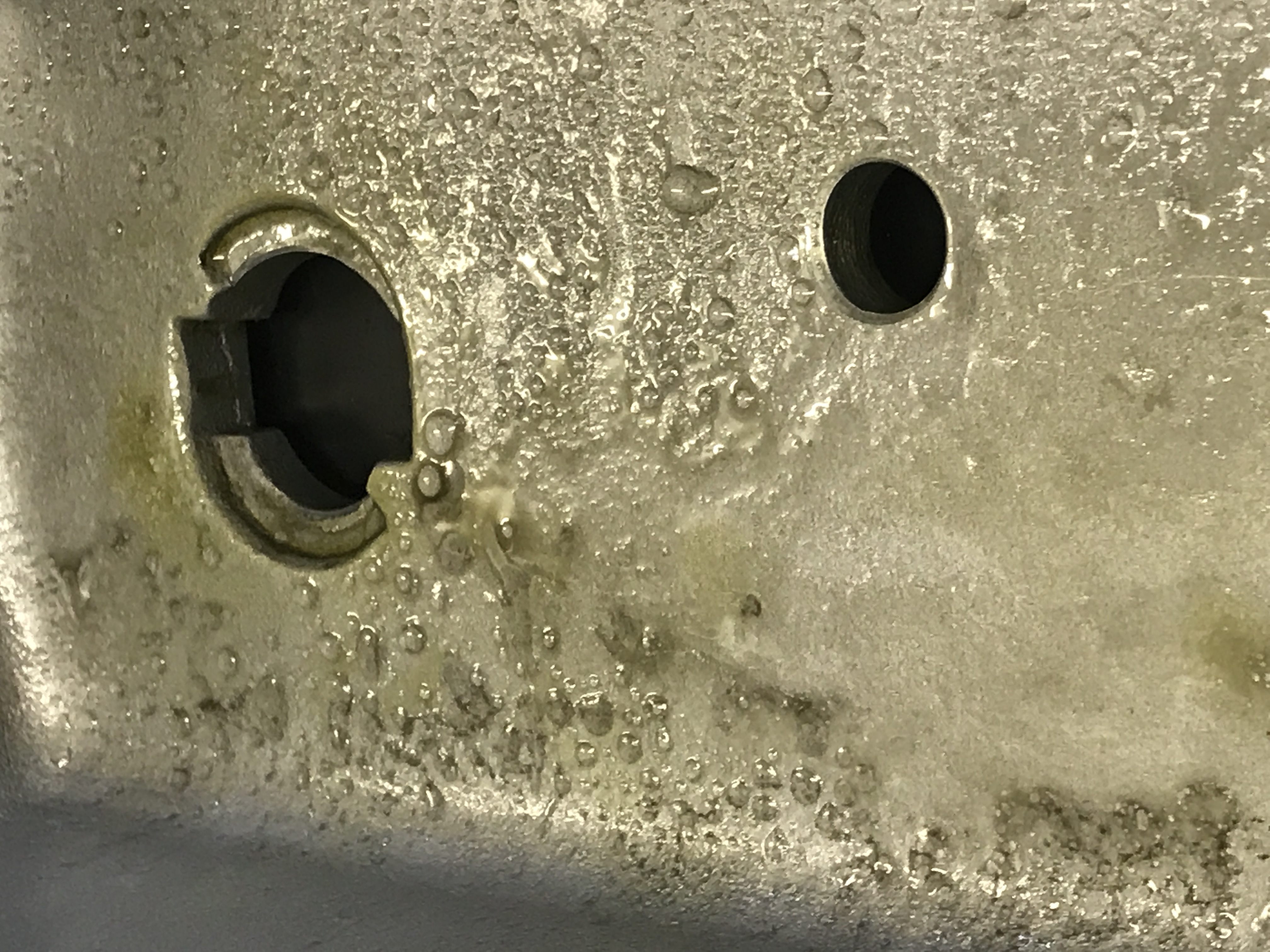

I now hear a tapping noise. I think it's coming from the engine? I thought I'd adjust the valves to find out if that's where the noise is coming from. I pull the valve cover to find water drops on the bottom of the oil cap and the bottom and sides of the valve cover. I also notice a puddle of yellowish liquid near the rear of the cylinder head.
I don't see white smoke from the tailpipes.
The dipstick is clean oil, not milky.
Would antifreeze in oil make the tappets loud?
Before I take everything apart to replace the gasket, am I correct I have a head gasket leak?
Is there a way to confirm that?
I look forward to your thoughts

I'll add that the 30 miles I have driven have been around town, not highway.
If the drops are antifreeze that's concerning. Maybe it's what was left in the engine/oil pan when I did the drain?
Or maybe those drops aren't antifreeze but condensation, because the 30 miles hasn't heated the oil enough to evaporate it?

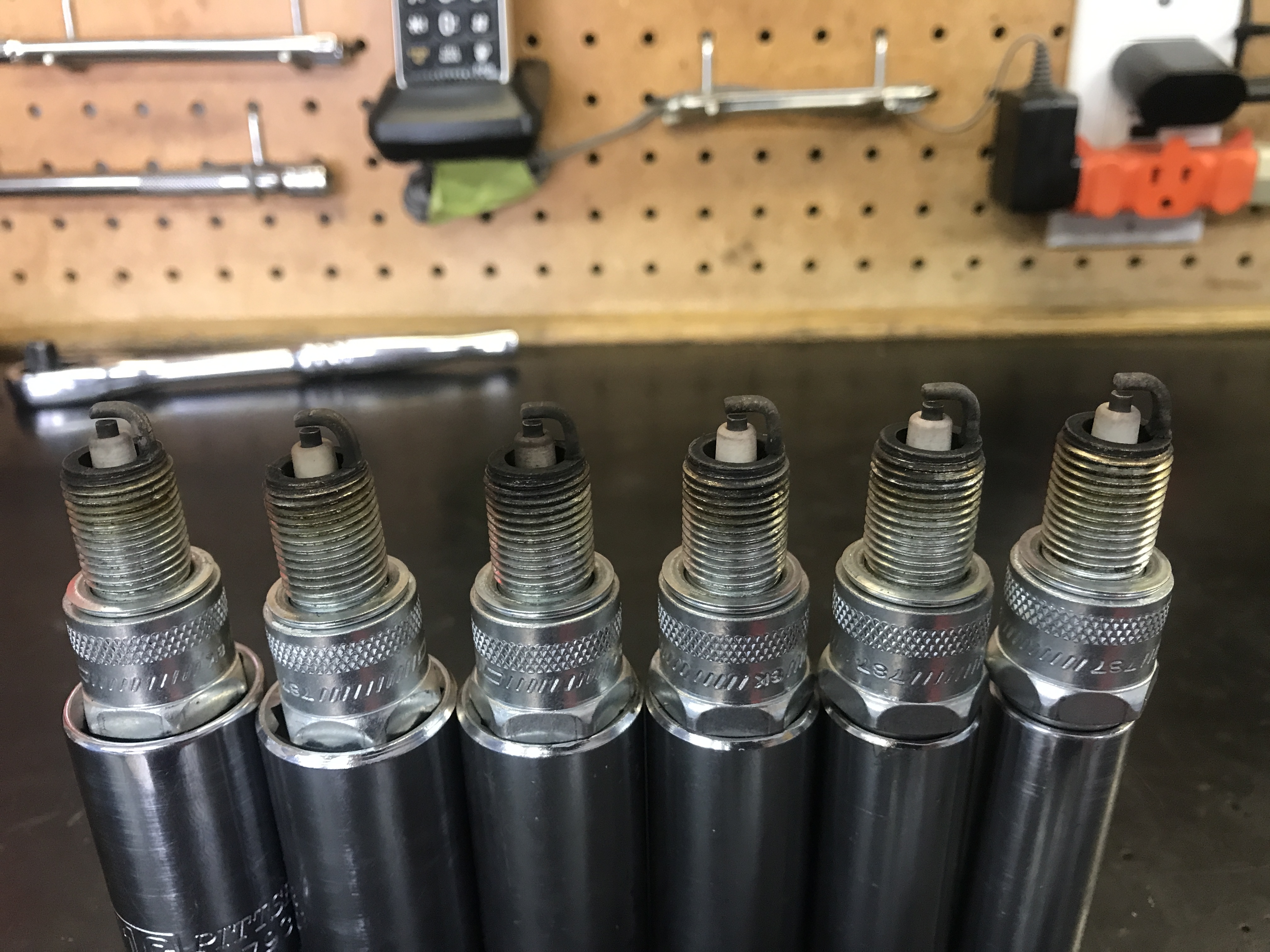

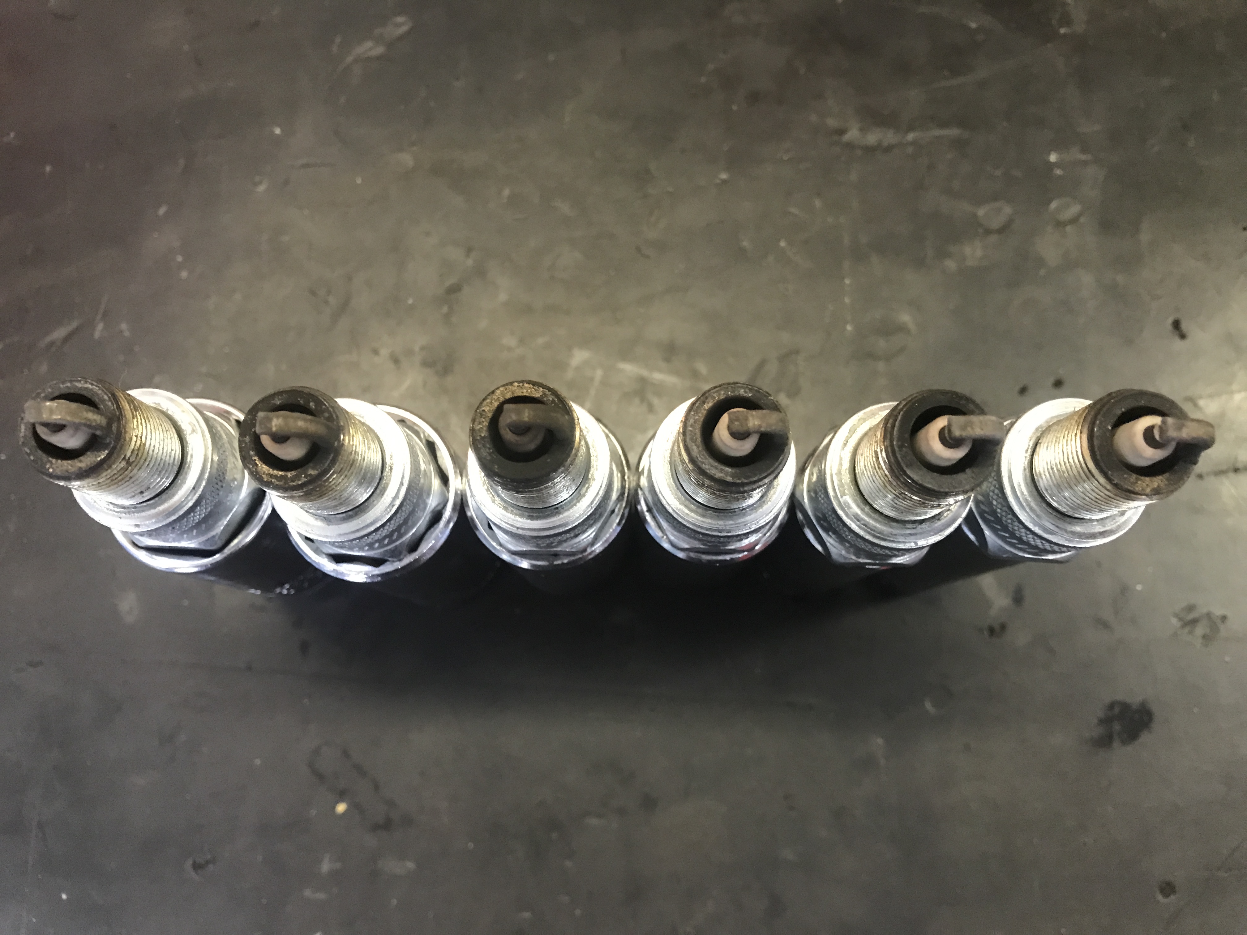

I've include photo of the spark plugs if that's of any help

I don’t think 30 miles is enough to get the engine and all it’s components up to prime operating temperature .
I would clean everything you can see . Check and set the valve clearances .
make an accurate note of your coolant level with a cold engine . A ruler into the fill cap to measure depth will work
Check and note oil level .
Take it for a good drive at least an hour even if it’s only circling the neighbourhood .
Watch for white smoke particularly under acceleration . Give it some beans in 2nd/3rd to check .
Let it all cool down overnight check and compare oil/coolant levels , remove valve cover and have a look what the results are .
bdcvg
Look for coolant on the dip stick. It will look like bubbles on the oil. Look for foam build up under the oil fill cap. Coolant eats engine bearings so be careful with a lot of driving until you are sure. A bad head gasket will also make coolant blow out the overflow tube. Get a coolant system pressure tester and pressurize your system and let it sit for awhile to see if it drops.
