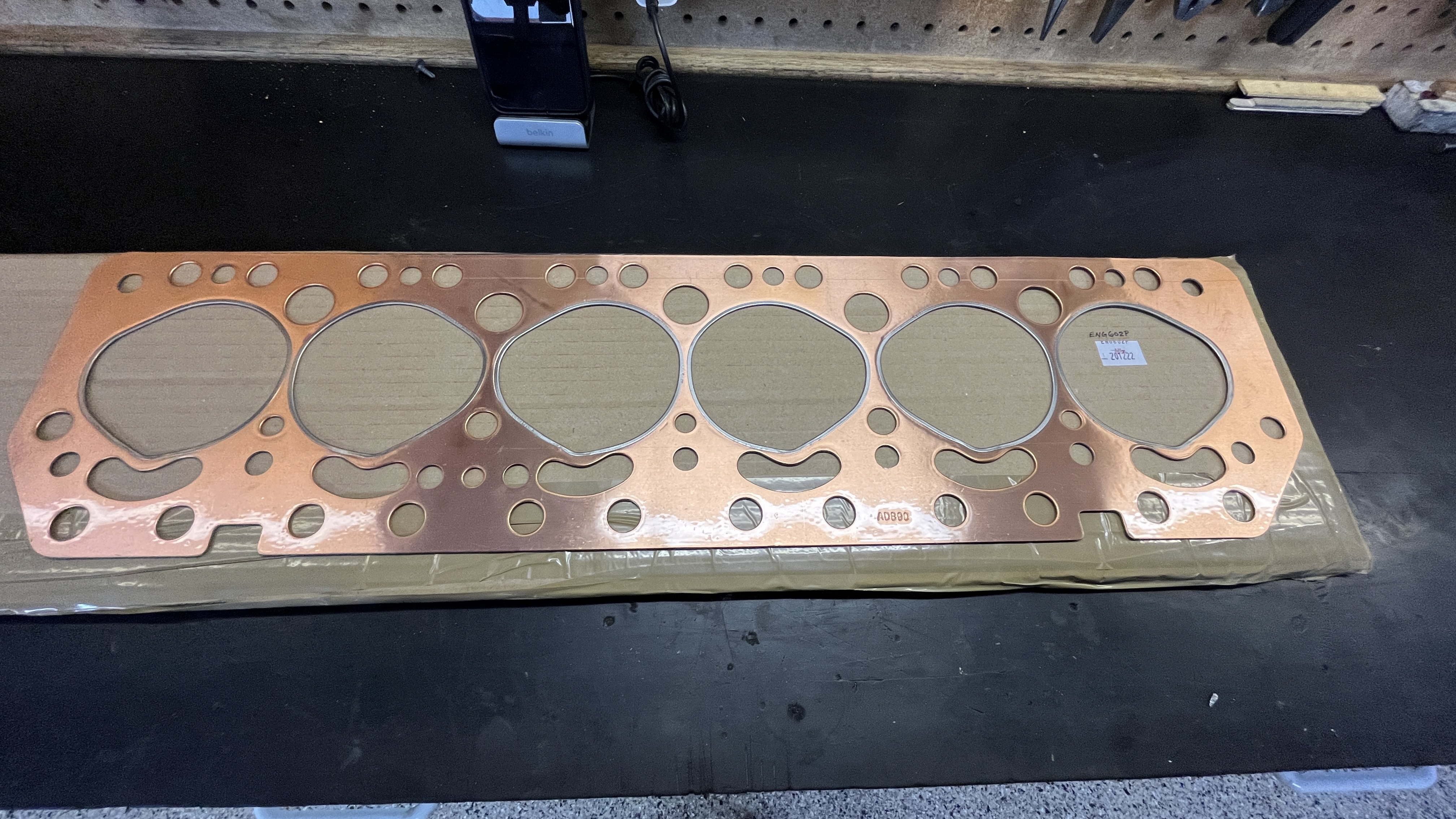

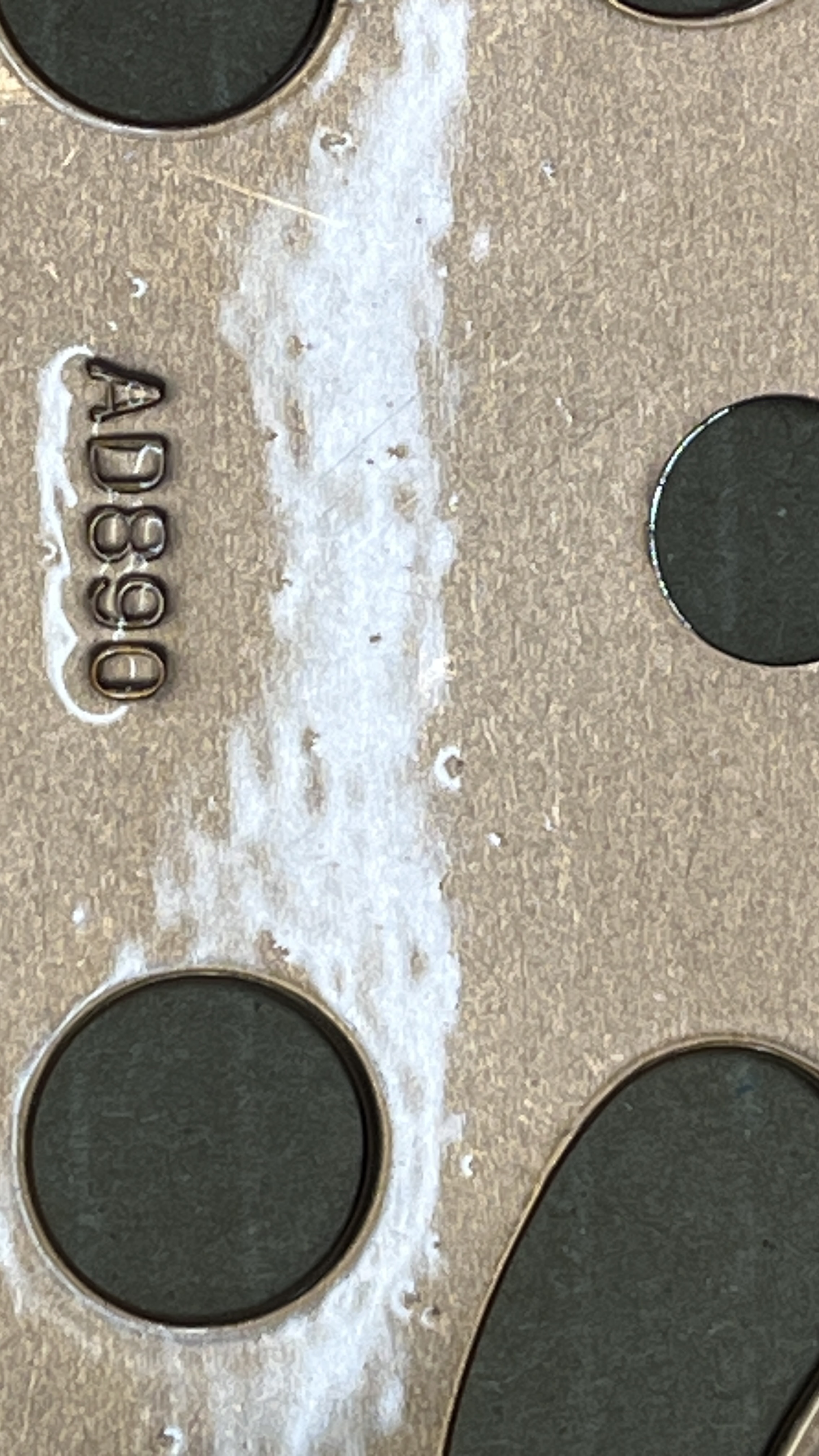

The BJ8 head gasket I received from AHSpares, part ENG602P, stamped AD890, seems to have a varnish-like substance.
AHSpares Description:
Gasket - cylinder head - High Quality UK made
These high quality head gaskets are made in the UK to exact original specifications from original tooling exclusively for A.H. Spares Ltd.
The materials used are of a very high specification so these gaskets are far superior to any aftermarket gasket currently available.

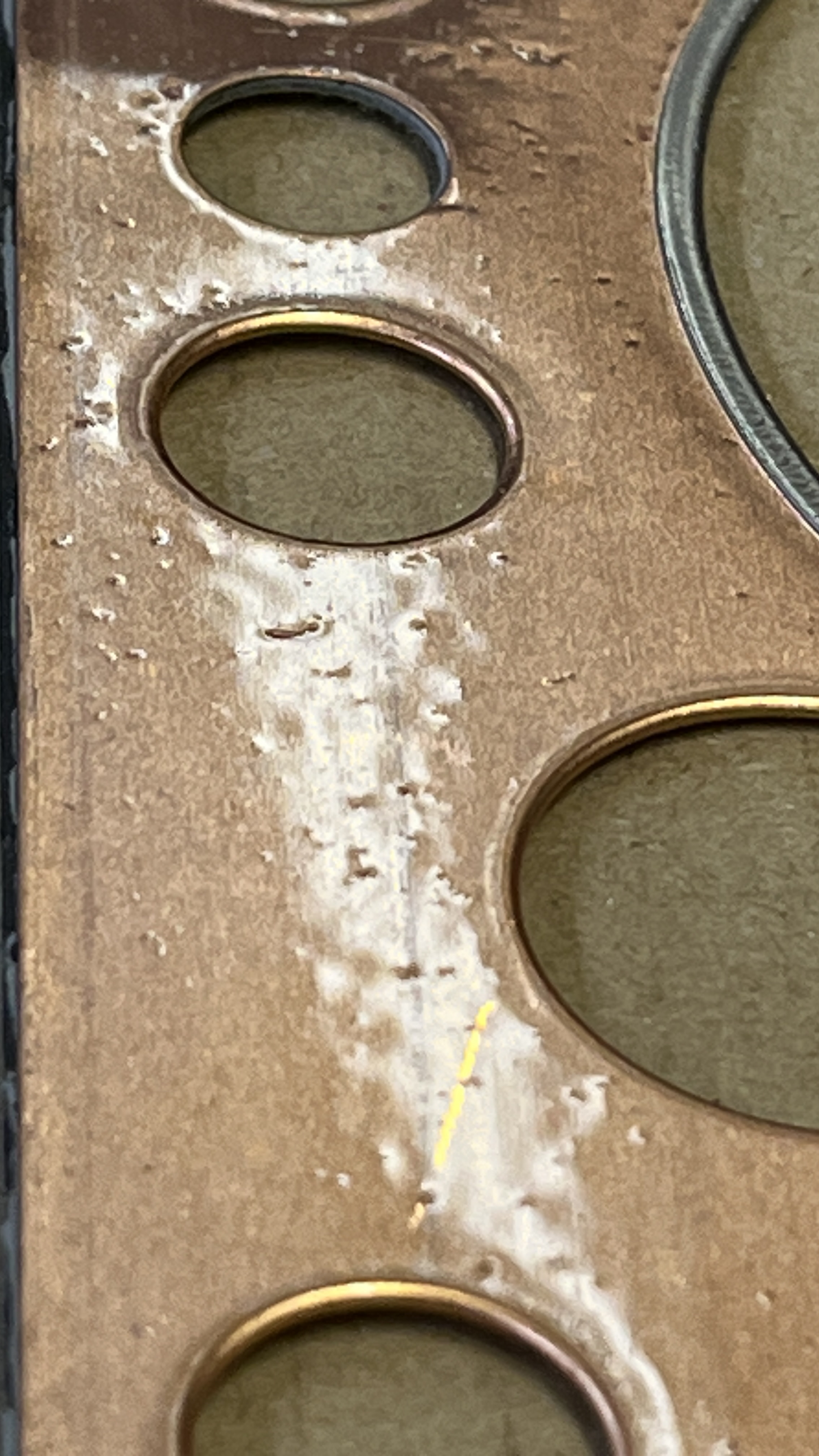

The gasket seems to be 3 layers. Top copper, middle? bottom some sort of steel? Something clear has been sprayed over the entire gasket. It's not sticky. It appears to have a very slight orange peel texture and what appears to be dust in that coating.
I've read that in preparation of installing a head gasket, both surfaces, engine and cylinder head should be absolutely flat, clean, no residue. Should I be concerned with the surface of the gasket I received? It appears to have dust in the clear coating. (see photos).
I've also noticed that there are places on the edges of the gasket that are separated. Is that normal?

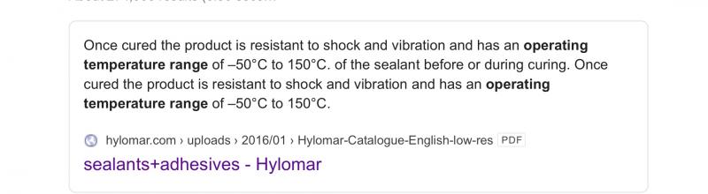

The manual says that the head gasket is to be installed dry, i.e. without sealants such as Hylomar.
With my Triumph TR3a, however, it was stated that the head gasket should be installed with Hylomar or something similar.
What is better now? Are there any experiences? My triumph has been tight for 10 years.

Hylomar, there are different versions.

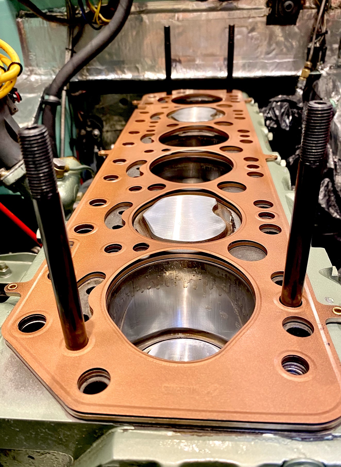

I will be using new ARP studs, washers and nuts, torqued to 75 fl/lbs in the order specified in the manual.

Prior post and included photos. Should I be concerned with the new head gasket I received?
1. Why does it have that clear coating on all sides?
2. What is the clear coating made of?
3. Is that dust in the coating and should I be concerned?
