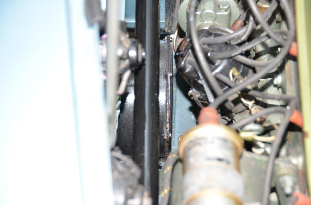

Thanks for all the suggestions, Still keen to look at moving the mounts to where the factory had them. For those with original boosters, when you look from the engine bay directly down on top of the booster where does the flat face line up with the chassis rail (see photo). Mine is currently lined up with the centre weld of the rail, should it be further outboard or is it in the right place?

Just checked my BJ8 with Girling servo and original mounts. The 'face' of the booster is pretty much exactly in line with the outer side of the chassis rail as seen from directly above (i.e. about a half chassis rail width outboard of where yours is). There is no gap--it's kind of like the face of the servo could be 'stacked' on the side of the chassis.
:iagree: Bob his is too far inboard
