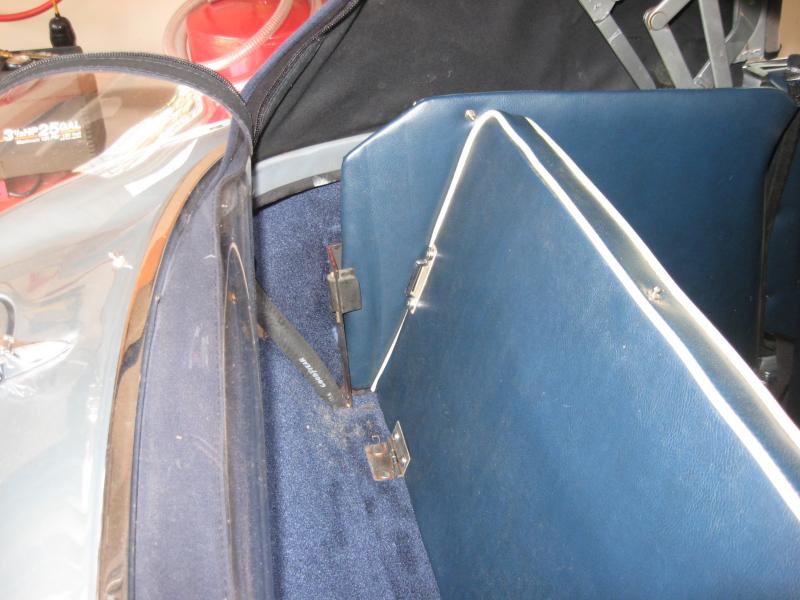

Someone proposed a question on another site of how to attach the rear seat back on a bj7 and where the slide out bolts go I'm not sure does the seat back fold down on a bj7 any photos would help
There are two vertical metal sections - one on each side - that have slots for a rubber securing block similar to that for the bonnet rod and boot rod. On the back of the seat back, there should be a chrome footman's loop on each side that will line up with the rubber, and allow the back to be pushed into position.
Bob
Any photos? I'm not understanding footman's loop or where there would be the rubber securing block. I have an early Phase 1 BJ8. They should be the same???
TH
heres a picture. bj8 i believe
