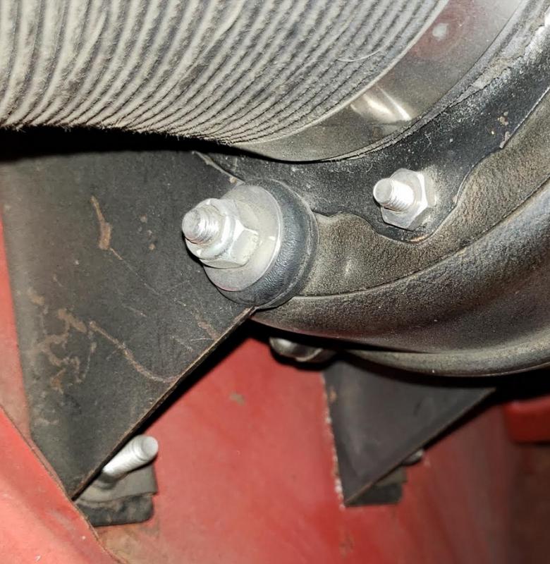

The blower unit is mounted with rubber grommets as vibration isolators. If they're shot, that could be the problem. (Note use of 1/4-20 u-nuts on feet for ease of removal/replacement of unit.)
I'll take a close look at the mounts tonight. Thanks Steve.
The blower wheel may have lost its balance weight clip . Look for a clean spot on one of the blades where it was . If it had one it would be a small piece of spring steel similar to the fender screw clips but much smaller .
Steve, the mounts are in good shape. couple years old.
