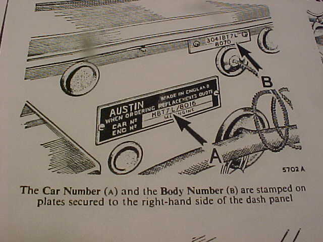

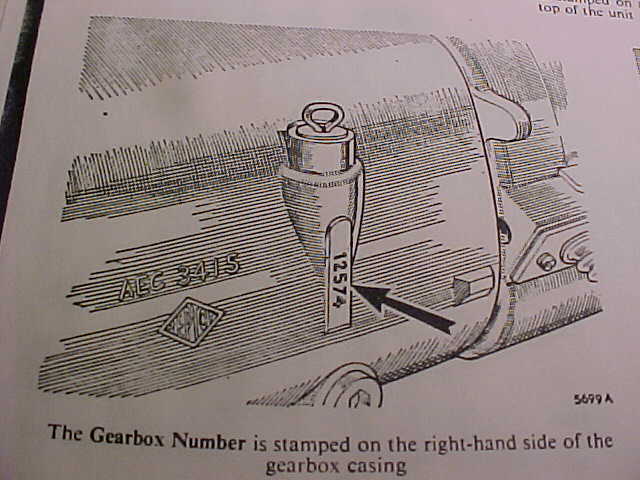

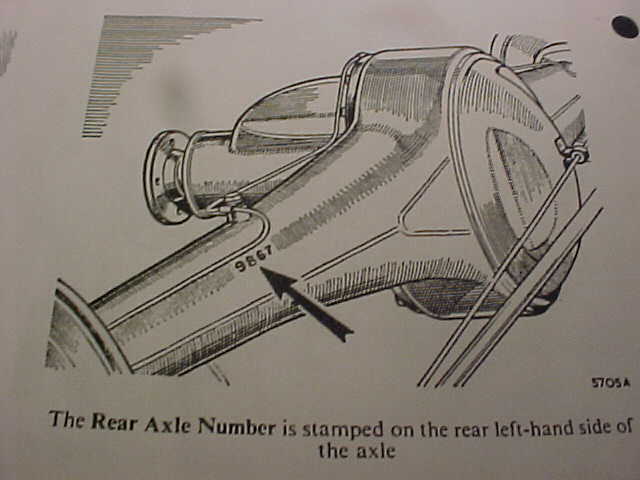

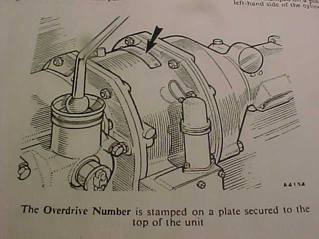

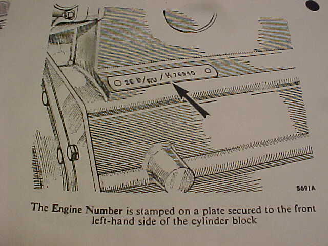

robert,johns correct, these picts might help see attch.in order 1-car and body# 2-engine# 3-overdrive# 4-gearbox# 5-rear axle#
