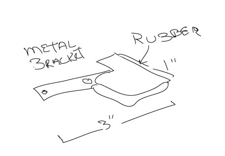

Oh I guess it could be made Andrew, if you had a clear picture of its shape and size. However, it is not just a simple piece of angled aluminum.---Fwiw--Keoke
Here's a drawing of what I "think" the bracket looks like based on the pictures. If anyone who has one could comment of the overall shape and provide dimensions it would be appreciated.
Cheers,
John
The mounting arm is 2" long X 1/2" wide the material thickness is ~ 1/8". The support portion [ Angled Piece] of the mounting arm is 7/8" long. Overall shape is excellent---Keoke
